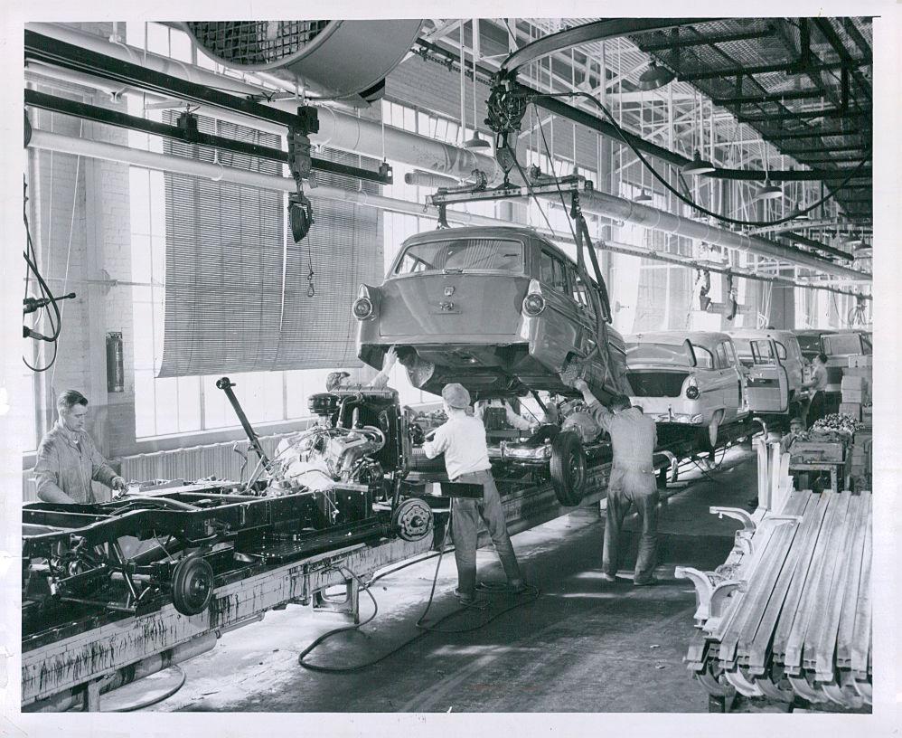

I too remember seeing assembly line workers using the 2x4 method of alignment at the Twin Cities Ford Assembly Plant during plant tours in the late 60's. They would just stick the 2x4 in the door opening near the hinge and slam the door. I believe in this case it was to get the door to move out, instead of move in. The Twin Cities Assembly Plant is gone now, but some great memories still exist.

Yeah, nelsb01....When I worked at the St. Paul Assembly Plant back in the mid to late '60's, I recall the large mallets they used along with the 2x4's to beat on the car doors, trunk lid and hood to align them. The heads of these huge mallets looked to be made of leather. These "adjustments" were made at the "final inspection" after the car came off the assembly line....

they used the 2by4 method on the assembly line at the Lorain Ohio assembly plant, made Falcons and Comets, in the 60s,
