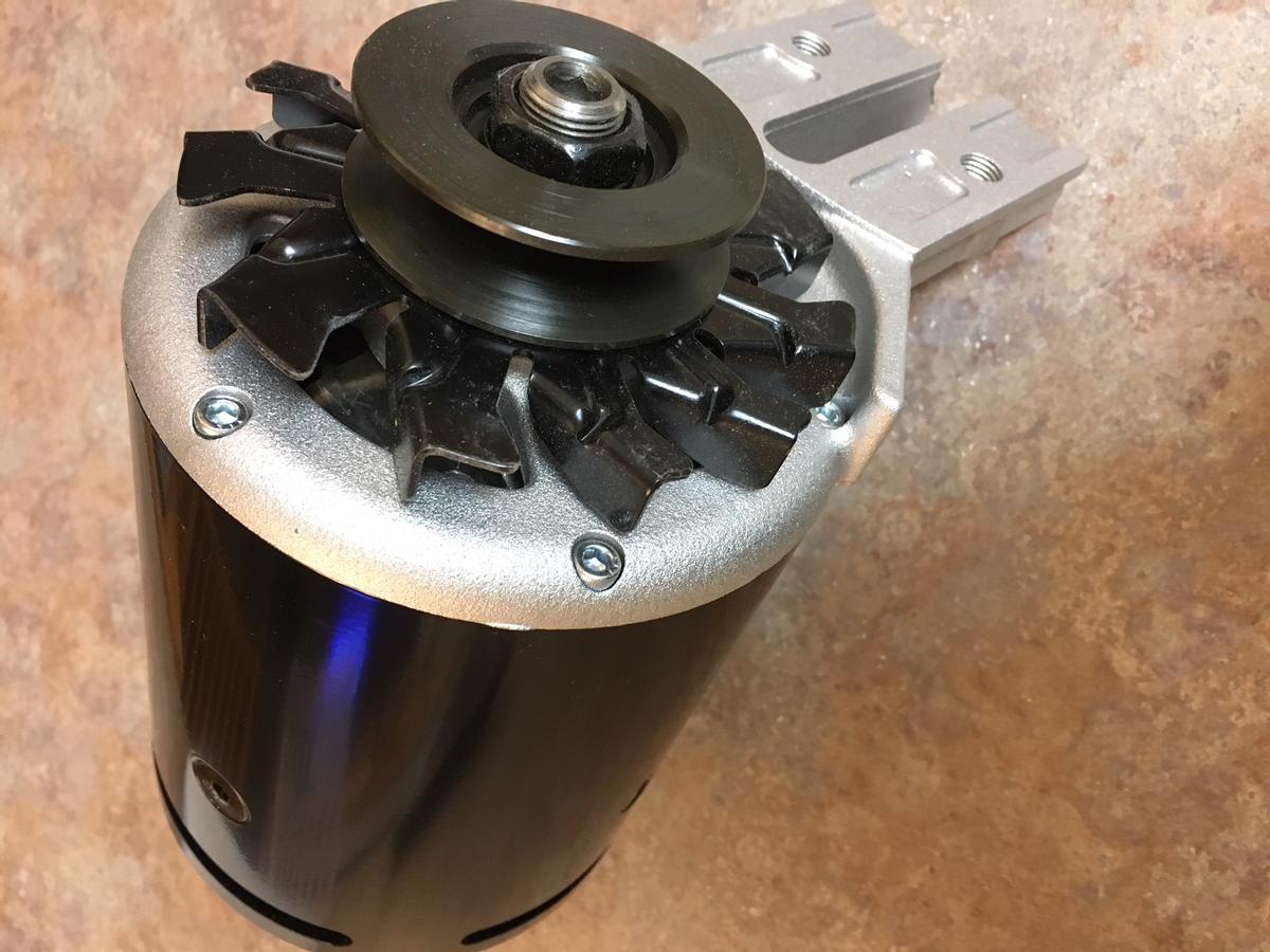

silverchief I struggled with my stock '46 charging as well. As there are no experts in my area I cheated and installed a Powermaster 6V 60A + ground alternator that is a bolt on unit c/w pulley. I got mine from Bob Drake, but Summit has better pricing now. I ran a #6 wire from the alt output to the battery side of the starter solenoid and a ground wire to a manifold bolt. I taped up the original gen wires and tucked them under the alternator and left the regulator I place so things look original. I could have done a different connection on the charging wire so there is an indication on the ammeter, but I have had no problems after two summers of fairly regular driving. The light are bright at night and don't go dim at idle.
