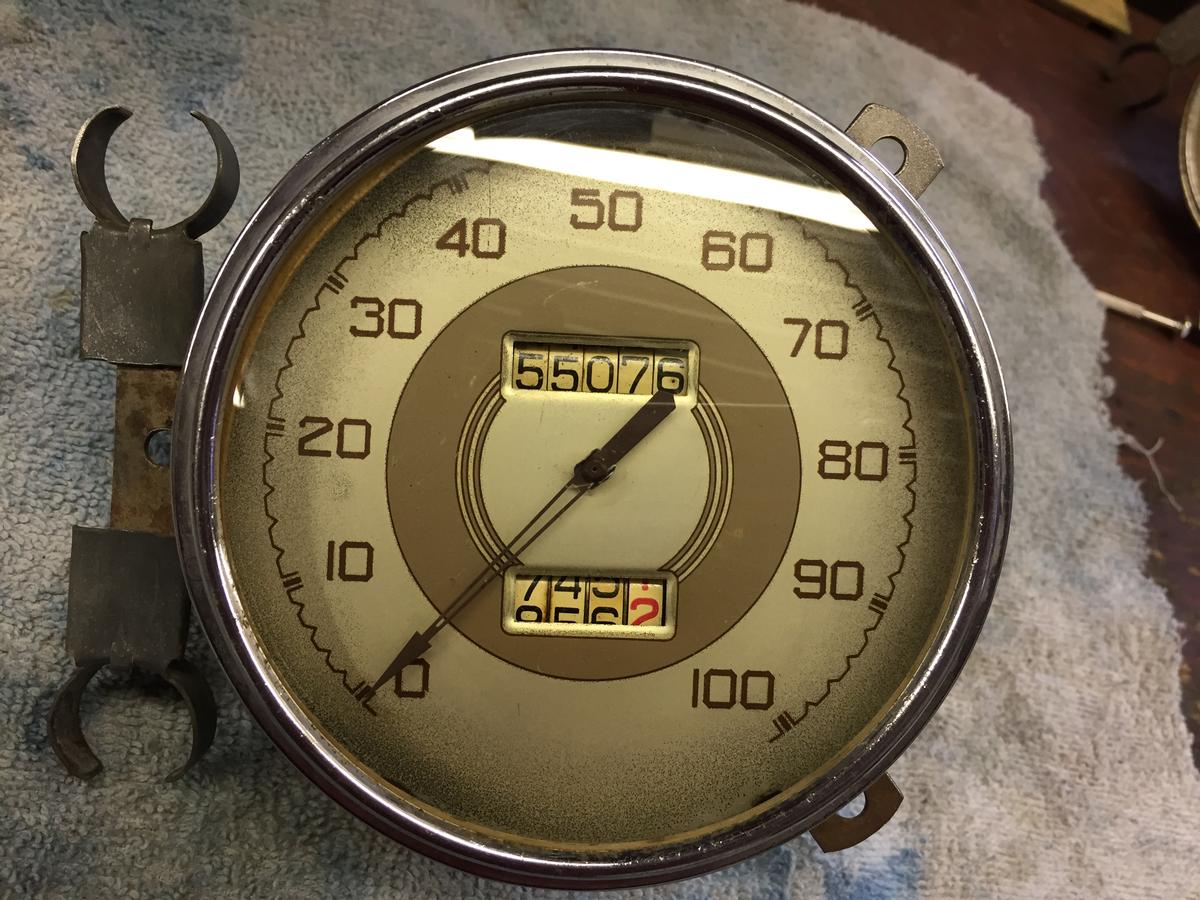

I am experiencing difficulties in removing the speedo needle in my 1937 Ford to replace the face plate. I searched the web and could not find anything on how to proceed. There were many sites providing speedo repairs but none for early Fords. I don't want to just start prying the needle off without knowing the consequences. I need help! Thanks, Jakes.

As I recall the needle is a press fit. It should come off just by pulling on it.

It is as advised, a press fit. I would suggest, if at all possible, apply a needle nose plier to the shaft before attempting to pull the needle off of it. I would not want to place any unnecessary stress on the speedometer shaft.

I removed the needle from the extra speedo that I had. The needle was pressed on very tight and with a little effort it came off undamaged using small pliers. I then proceeded to remove the needle from the speedo that I wanted to replace the face plate, thinking that I could just switch face plates from the two speedo's. All went very well except that the two face plates (even thought they were both from 1937's were different), the holes for the odometer and the trip meter was not the same. I could not see that they were different until I matched them up. So I cleaned up the one I wanted to replace and reinstalled it. It looked a lot better (see attached photo). If someone was to purchase a new speedo face plate make sure that the holes are in the same location, otherwise you will not be able to fully see the numbers. Jakes

Ford used different vendors for their speedometers. As I recall the two vendors were Waltham and Stewart -Warner. This would explain the difference in the faces. The back side of the speedo should indicate the manufacturer.
