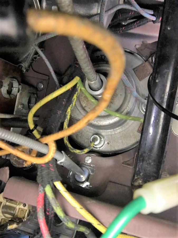

I believe that this is the spot you are looking for, that trjford8 is talking about.

I already thought of that. My grandson is only 12 but his father is a bit more flexible than I am. Thanks for the thoughts and the photo.
