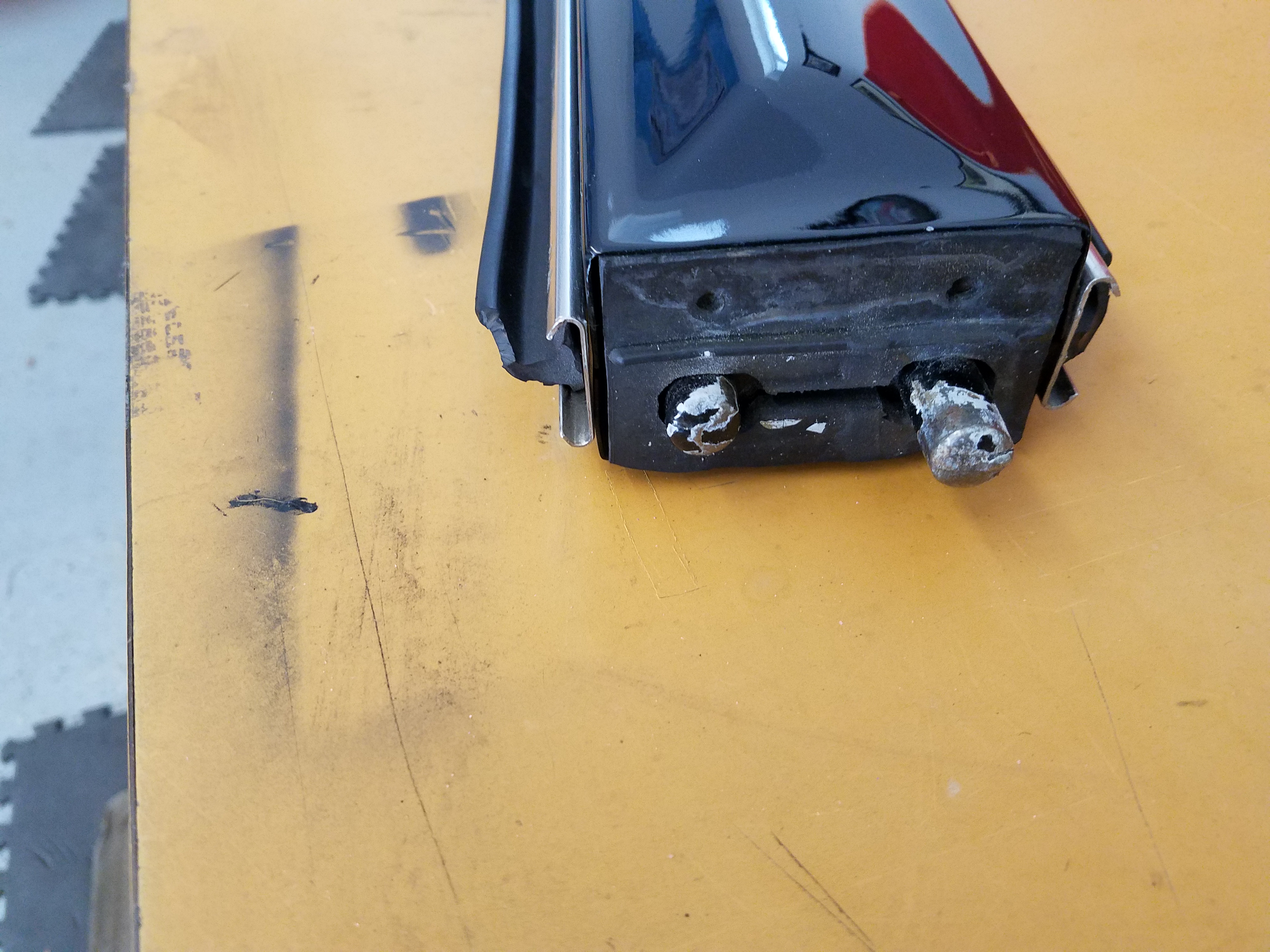

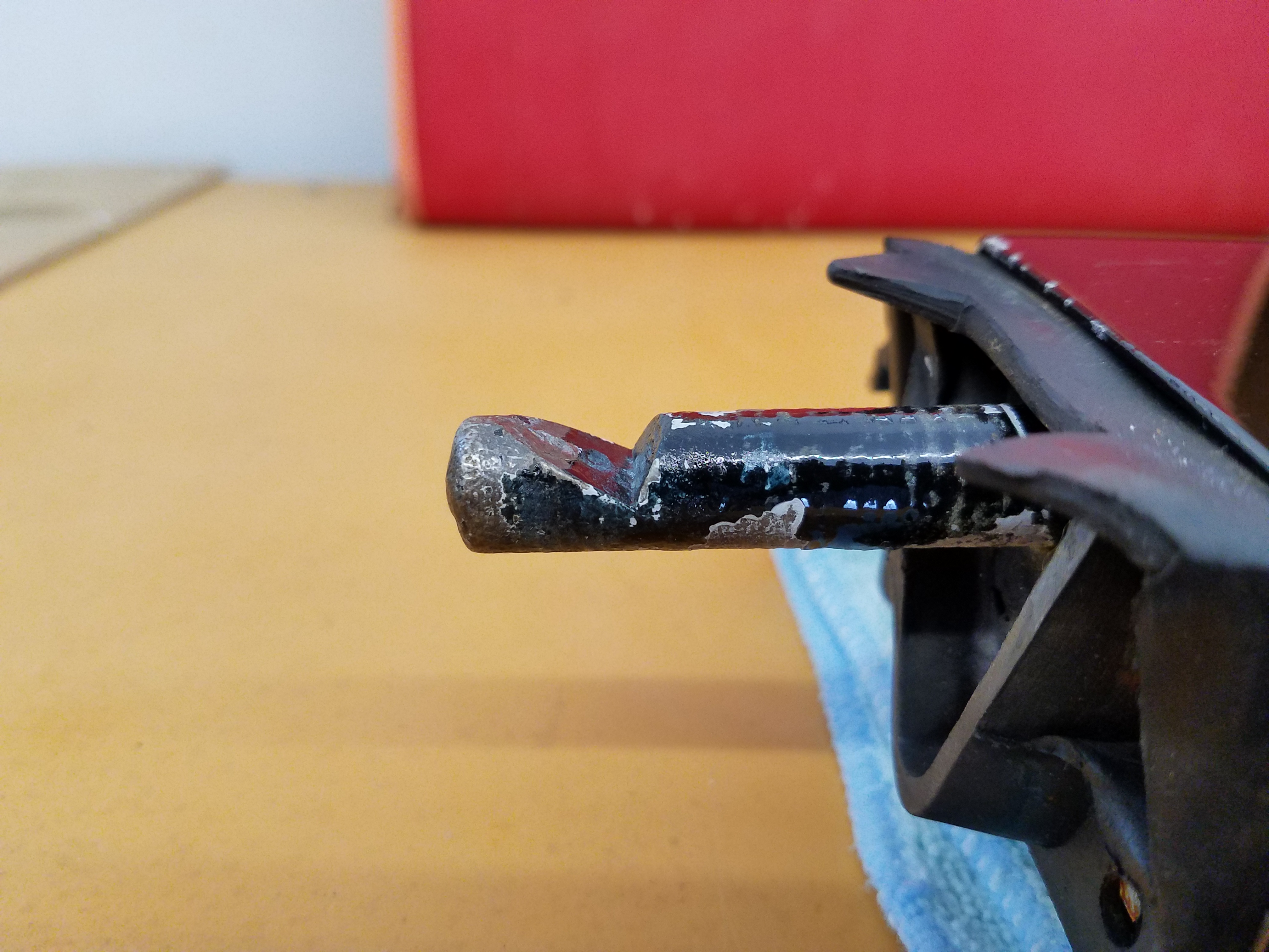

there should be one hole in one end of the post and two holes in the other end. There are studs that go into the holes. The single long stud goes in the bottom and the two shorter studs fit in the top. There are stainless strips to hold the window weather strip on either side of the post. Two of the studs have a v groove in them that the hold down screw engages to hold them in. Here is the first of several pics.

If you don't have the studs, you will probably have to make them as no one repops them. If you needs dimensions or any other info let me know and I'll see what I can come up with.
