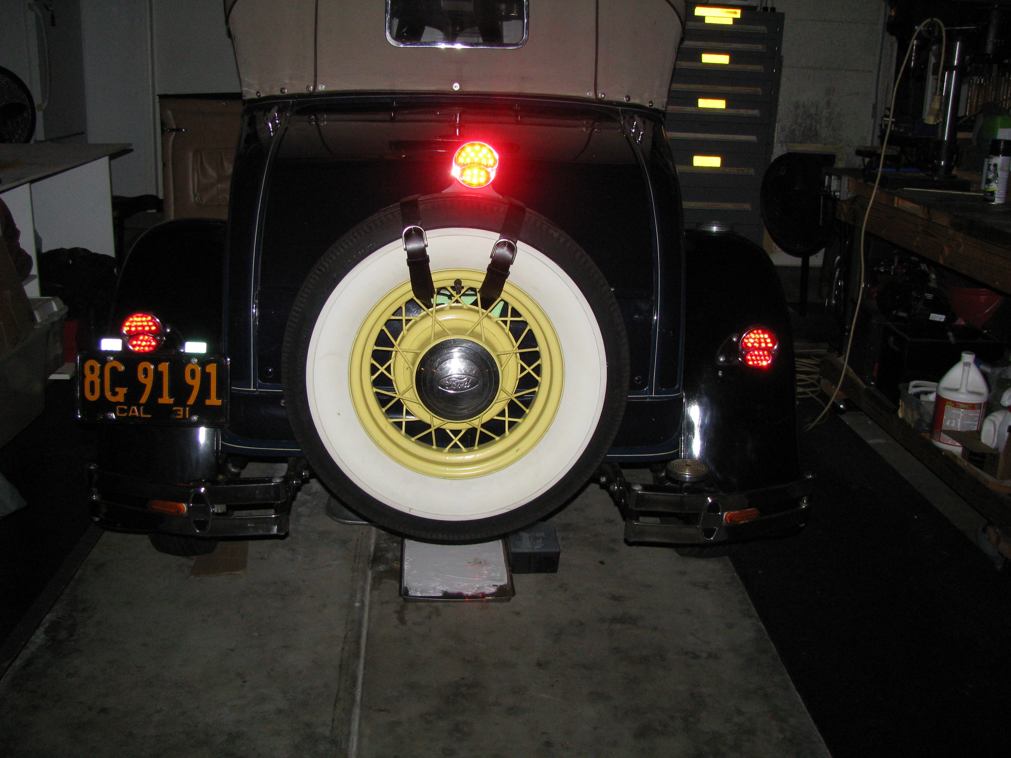

What a stunning "A"! Do i see a third/high mount stop light on that GR8 car? mike

Mike, here's a shot of the third brake light. A couple cheap belts some sheet metal and an LED A twilight and an hour or so.
