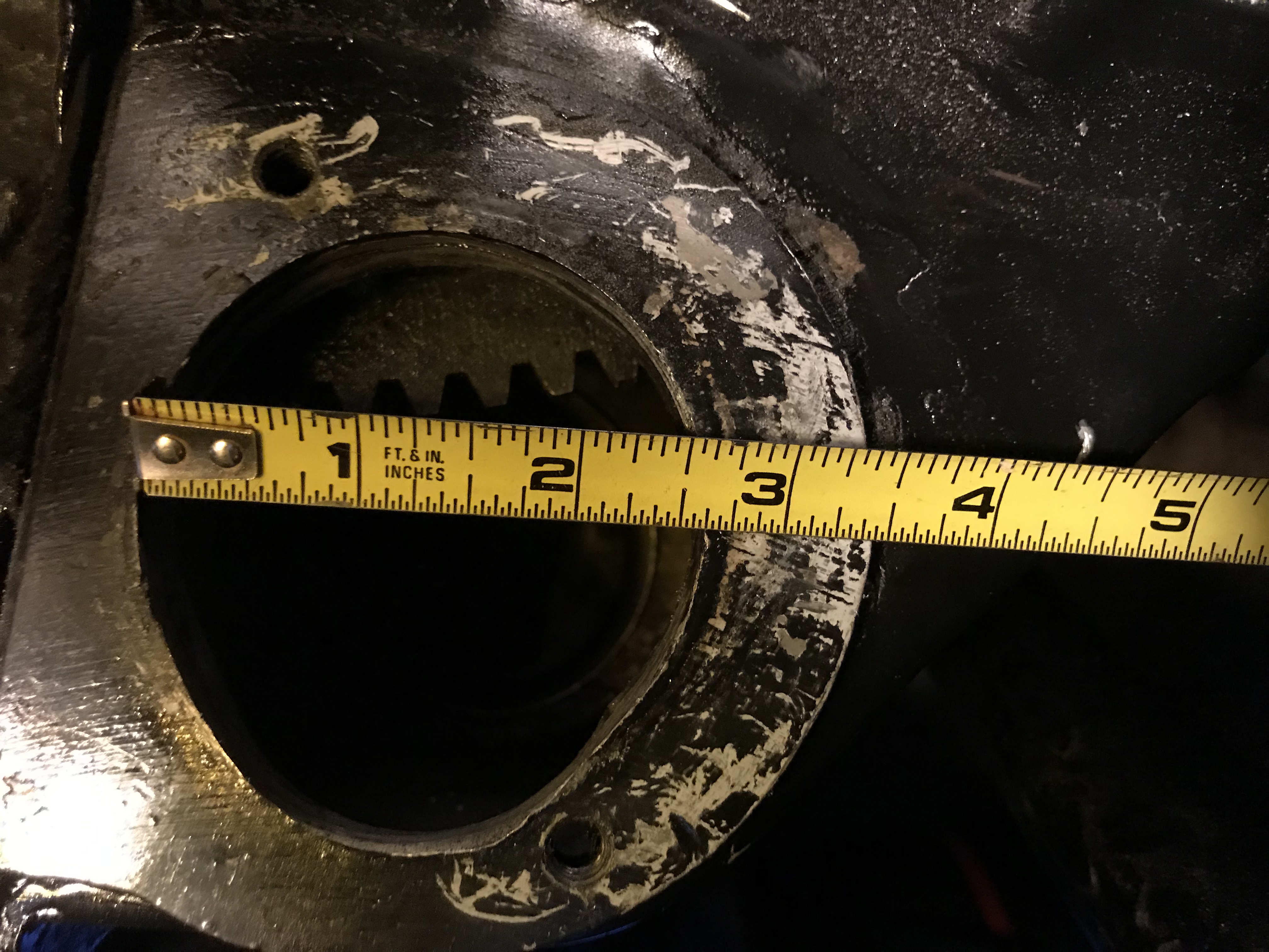

Pic of hole in pan. Diameter barely 2.5”.

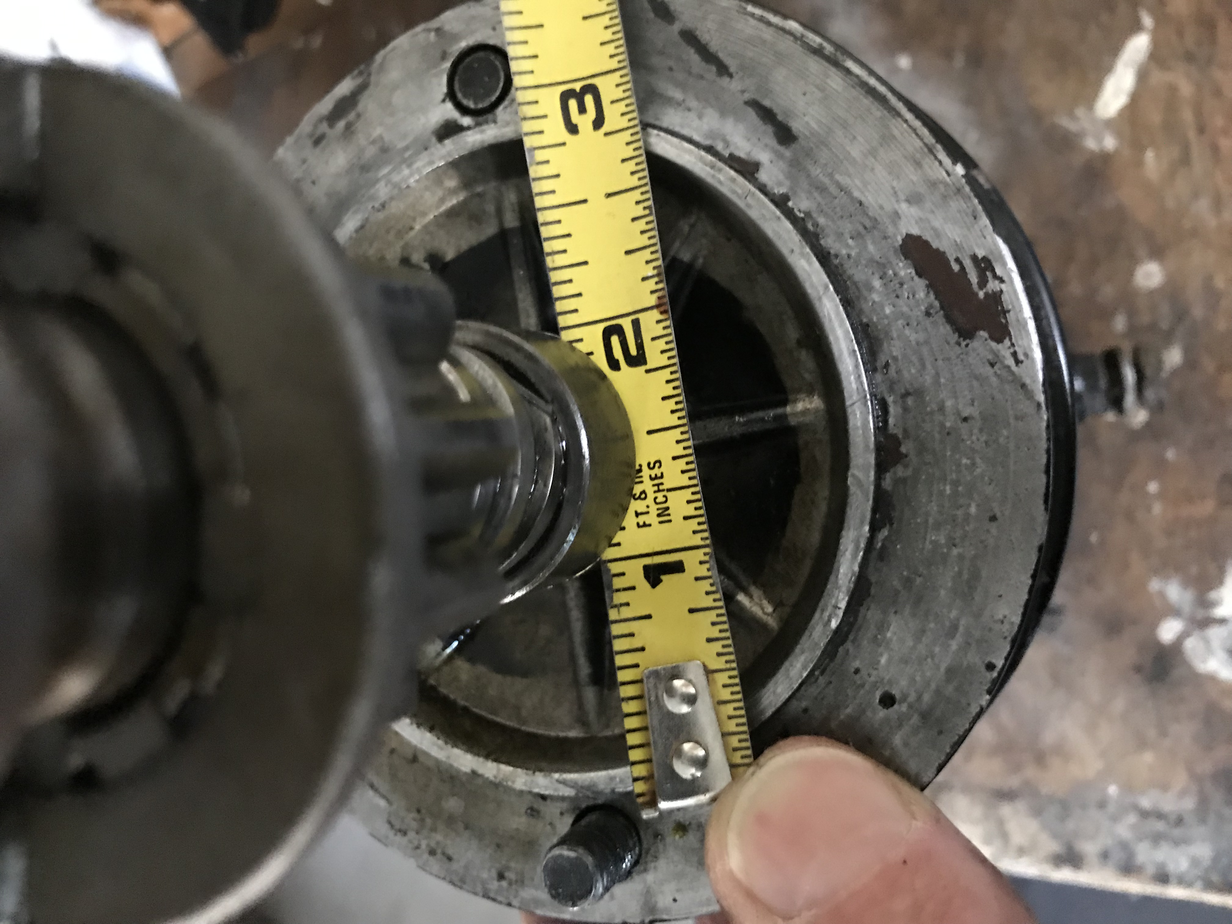

Pic of starter

I'm stumped, but it's pretty obvious that that starter does not fit that pan.

Okay from the pictures we know that the pan and the starter don't fit together. So now the questions.
1. Hopefully you live near other Ford folks who have pans or starters you can compare to yours.
2. Since you are replacing the engine will your 36 pan fit on the new engine?
3. Does the pan on the new engine fit correctly or was it modified in some way to fit?
4. Perhaps someone at Vanpelt Sales can tell you what you are looking at.
My suspicion is that you have a 49 or later oil pan and there once was a starter with a smaller flange that went with it.
Let us know what you find out. This is an interesting question.
01-13-2019 @ 7:35 AM
Posts: 4357
That hole for the starter does not look round. It looks like somebody added a handmade plate to the pan for the starter. It's a JDLR(just don't look right) situation.
01-13-2019 @ 7:51 AM
Posts: 7386
I agree with Tom. It just doesn't look right and if you started grinding to open the hole, you may not get it in the correct position to keep the starter in alignment with the flywheel.
I would look for another oil pan or use the one from the 1936 engine.
