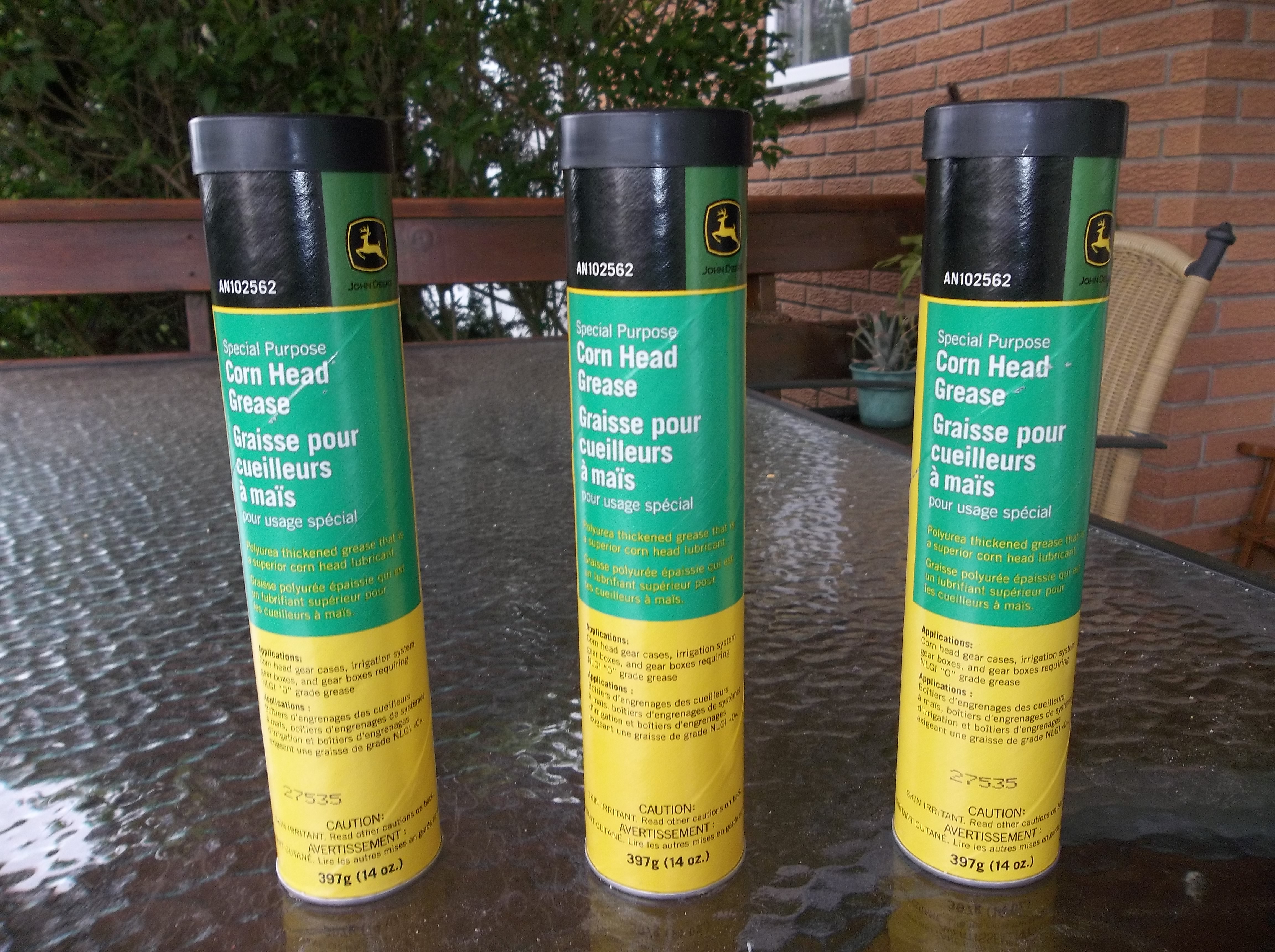

The John Deere product is called special purpose Corn Head Grease. Their stock number is AN102562 (see photo).
Two gentlemen in this club, for whose opinions I have the utmost respect, believe that this corn head grease is not an ideal early Ford steering box lubricant.
We have used it in our '36 since 2013 without any noticeable adverse effect. The car steers very well, and this grease does not leak out of the box. Not a drop, in over 8000 miles during the last five years of cruising.
It's not hard to install. With the steering box empty and the filler plug removed, the procedure is:
1. jack up the car a couple of inches in the middle of the front axle
2. using a large veterinarian's syringe, slowly squirt grease into the box until it looks full
3. rotate the steering wheel back and forth ........ this pulls the corn head grease down into the box
4. repeat steps 2 and 3 until the box really is full
5. drive a few miles and double-check
From time to time I re-check the steering box to make sure that it's still full. It is. Every time. So far, no additional corn head grease has ever had to be added.
