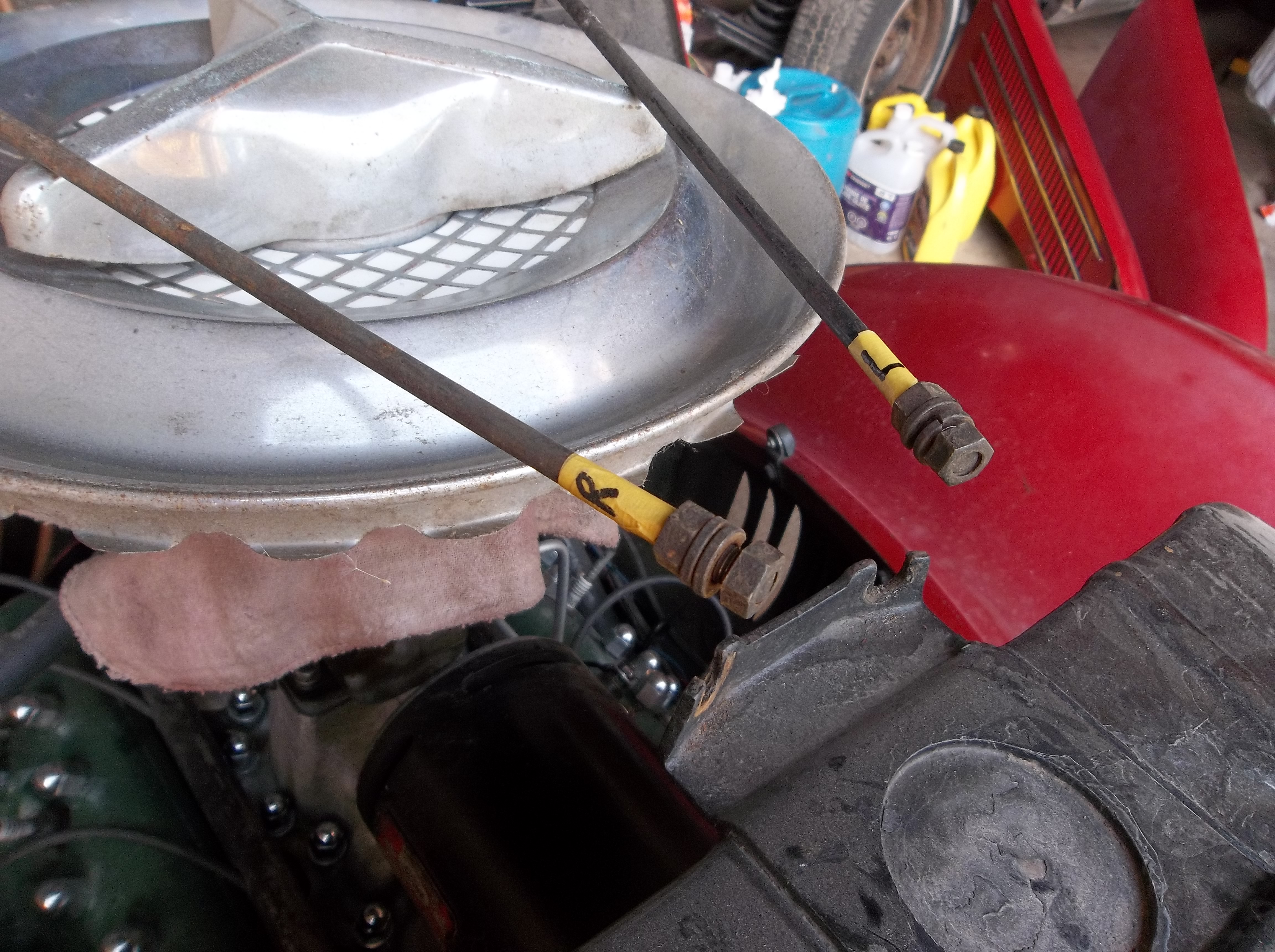

09-20-2018 @ 6:18 AM
Posts: 559
Photo 2 ......
Next the radiator support bars were undone (shown supported by a Fiesta flipper bar hubcap for the purpose of taking this shot). They are marked L (left) and R (right) for re-assembly later.
A rag is protecting the top of the air cleaner.
Not shown is a thick piece of cardboard inserted behind the rad to protect its cooling fins from being damaged by the fan or the distributor.
Unlike John, I had decided to take the grille right off. Removing water pumps was therefore not necessary, and as an added bonus the front of the engine was fully accessible for cleaning and painting while the radiator was out being repaired.

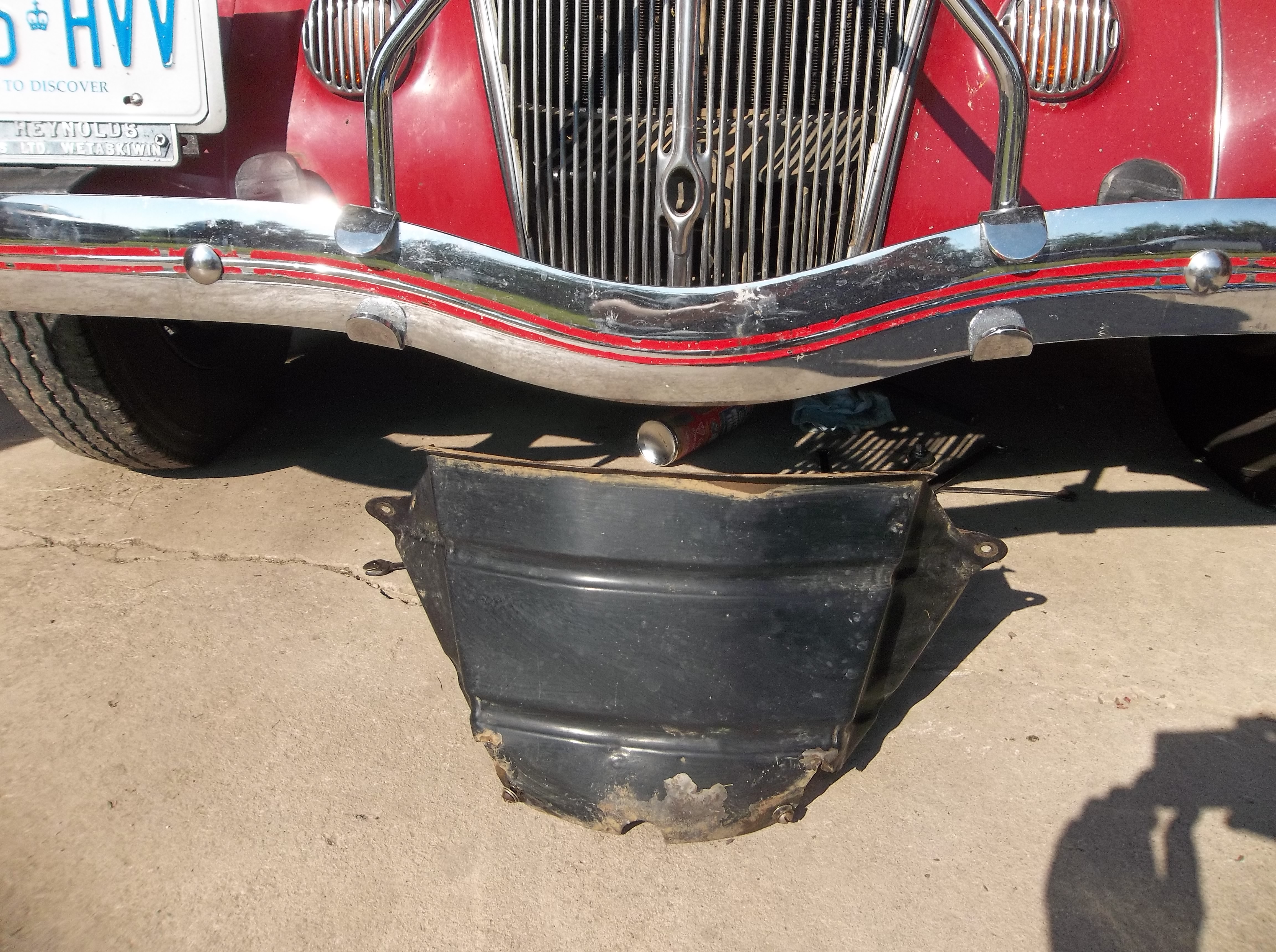

09-20-2018 @ 6:20 AM
Posts: 559
Photo 3 ......
The pan below the radiator has been removed.
Grant

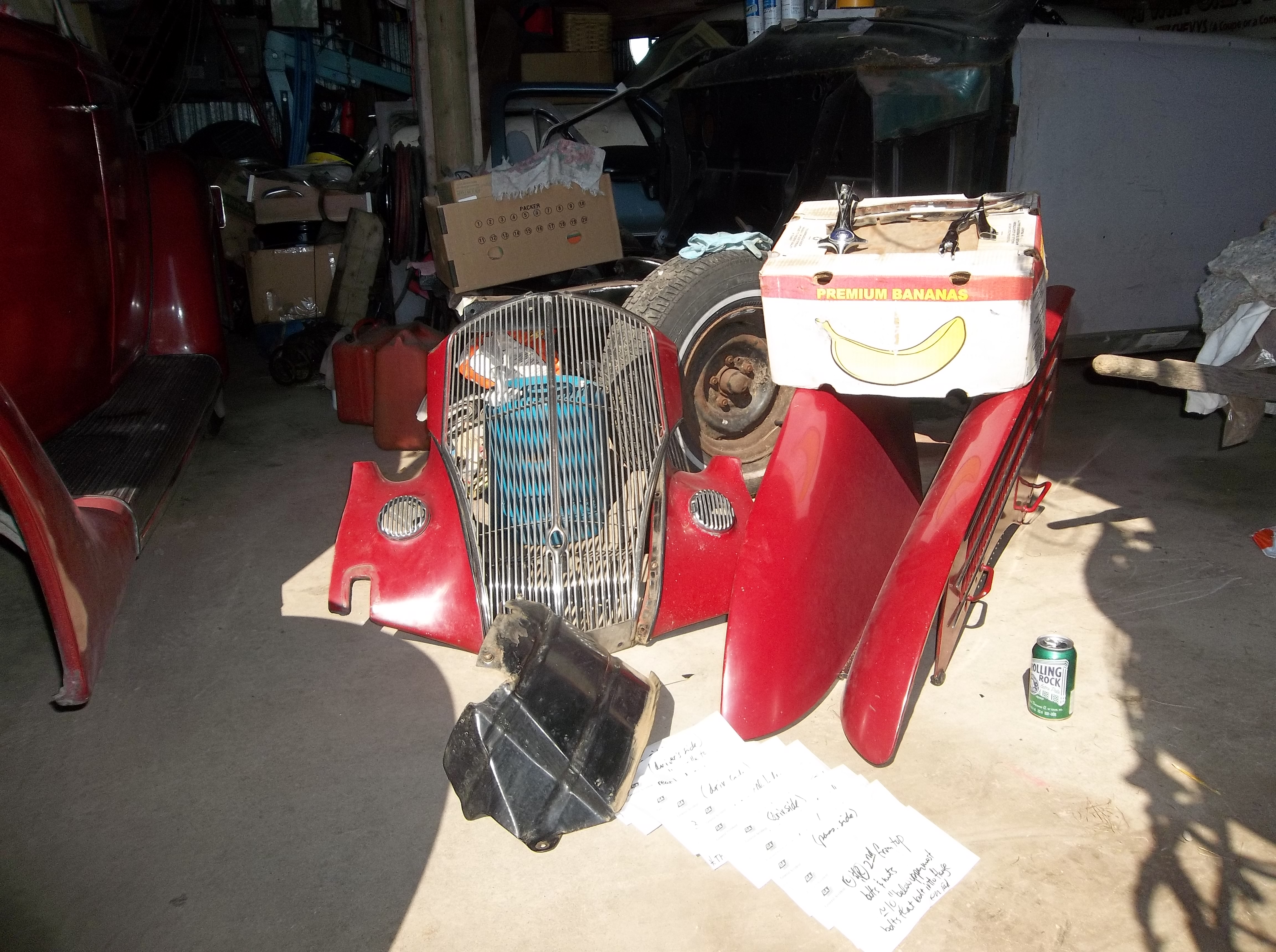

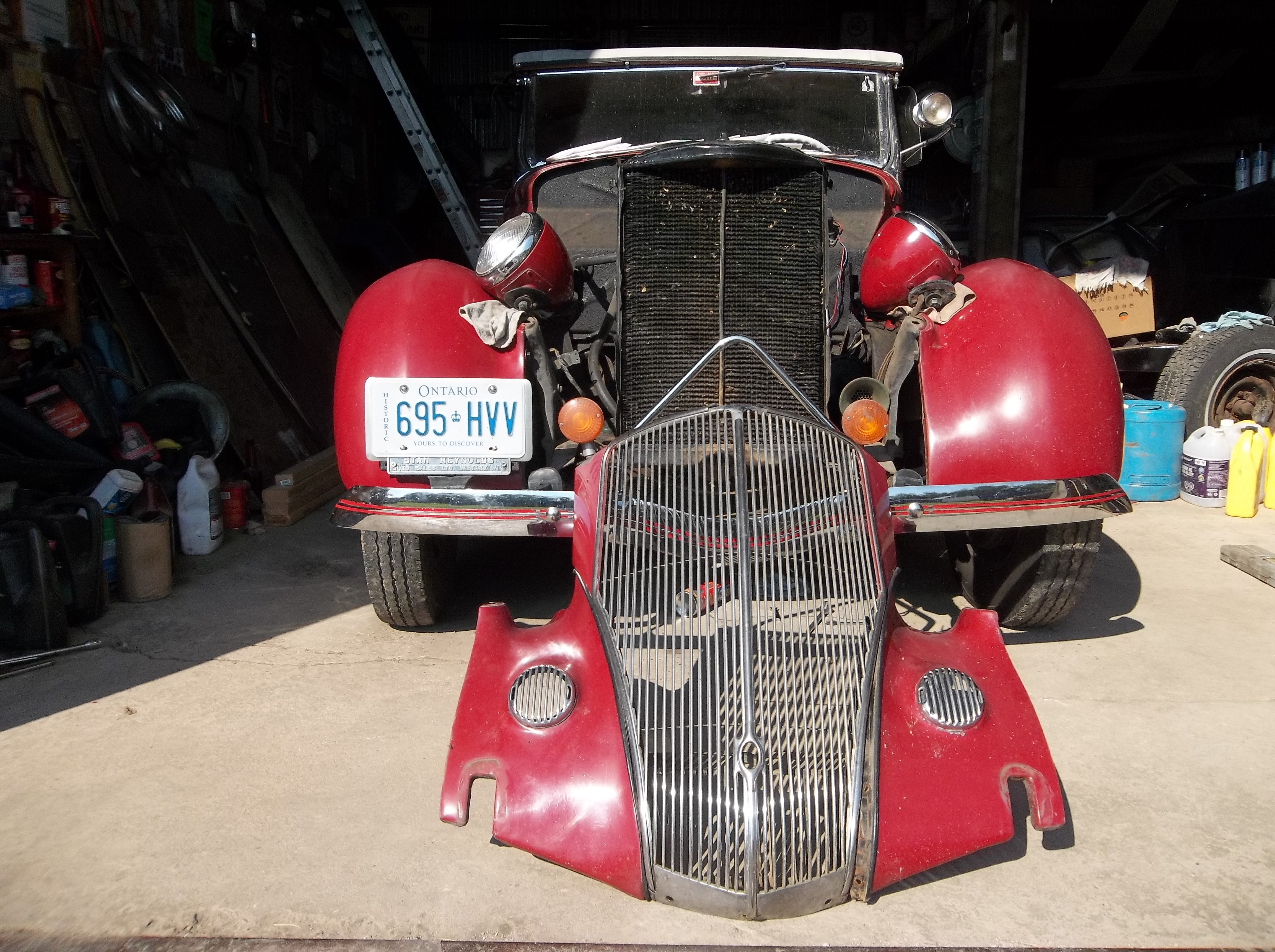

09-20-2018 @ 6:27 AM
Posts: 559
Photo 4 ......
The headlights have been laid back on rags. Next the horn panels and grille were removed.
I'm thinking that the different front end on your 1935 Fords would allow you to take the grille off ........ or maybe just loosen it and tilt it forward ......... without having to remove the headlights or horns.
Perhaps this decision will be driven by whether or not you want to clean up and paint the engine while you're waiting for the rad to be re-done.

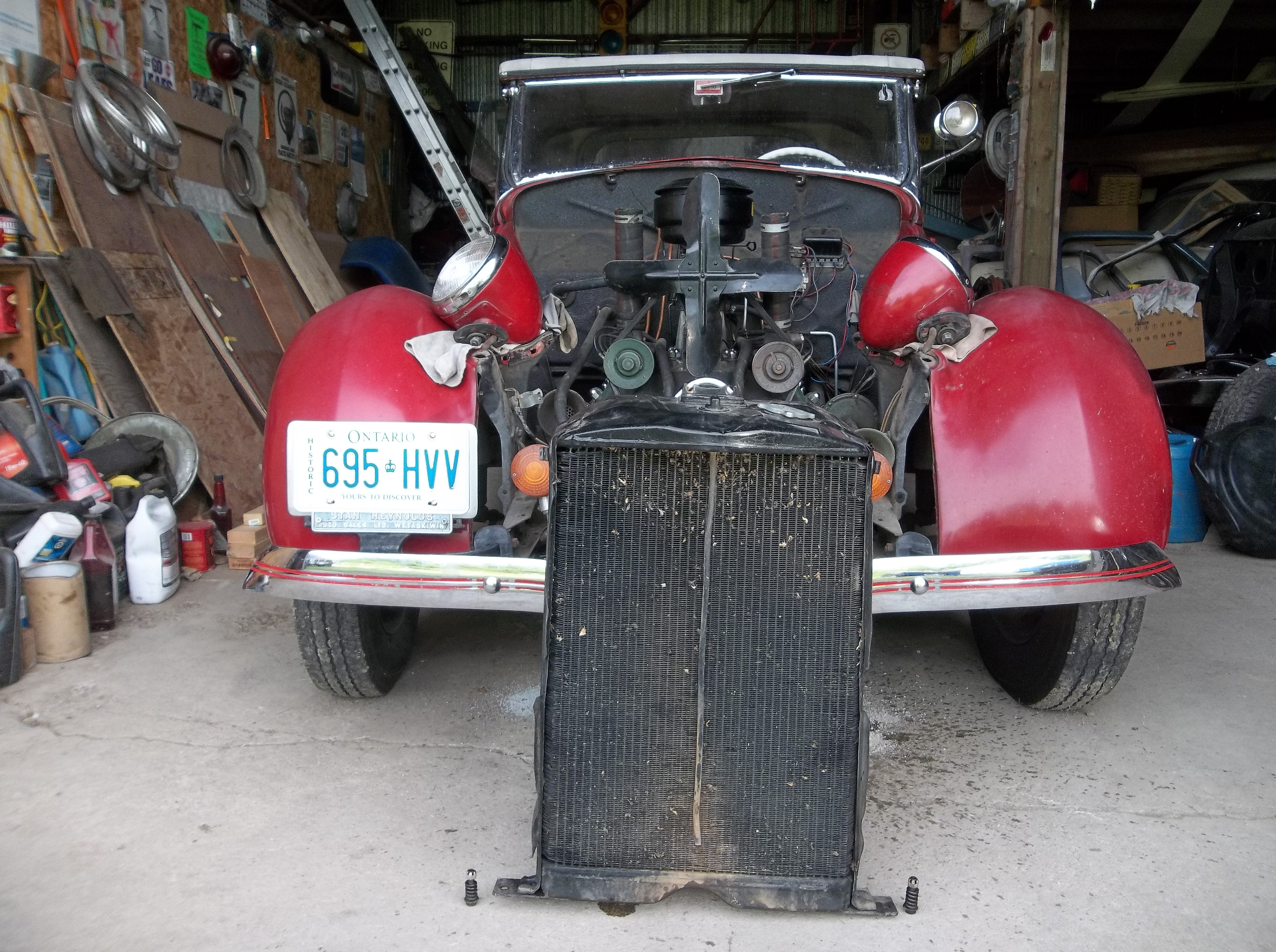

09-20-2018 @ 6:39 AM
Posts: 559
Photo 5 ......
It's out! The last step was to carefully remove the rad hoses without damaging the radiator outlets.
Easier said than done. All four were stuck. Henry's Revenge strikes again. This was probably the hardest part of the job.
With all eight clamps loosened and hot water poured on the hose ends, the rubber softened up. Gentle prying eventually loosened the hoses.
After that only the spring bolts at the bottom remained to be undone.

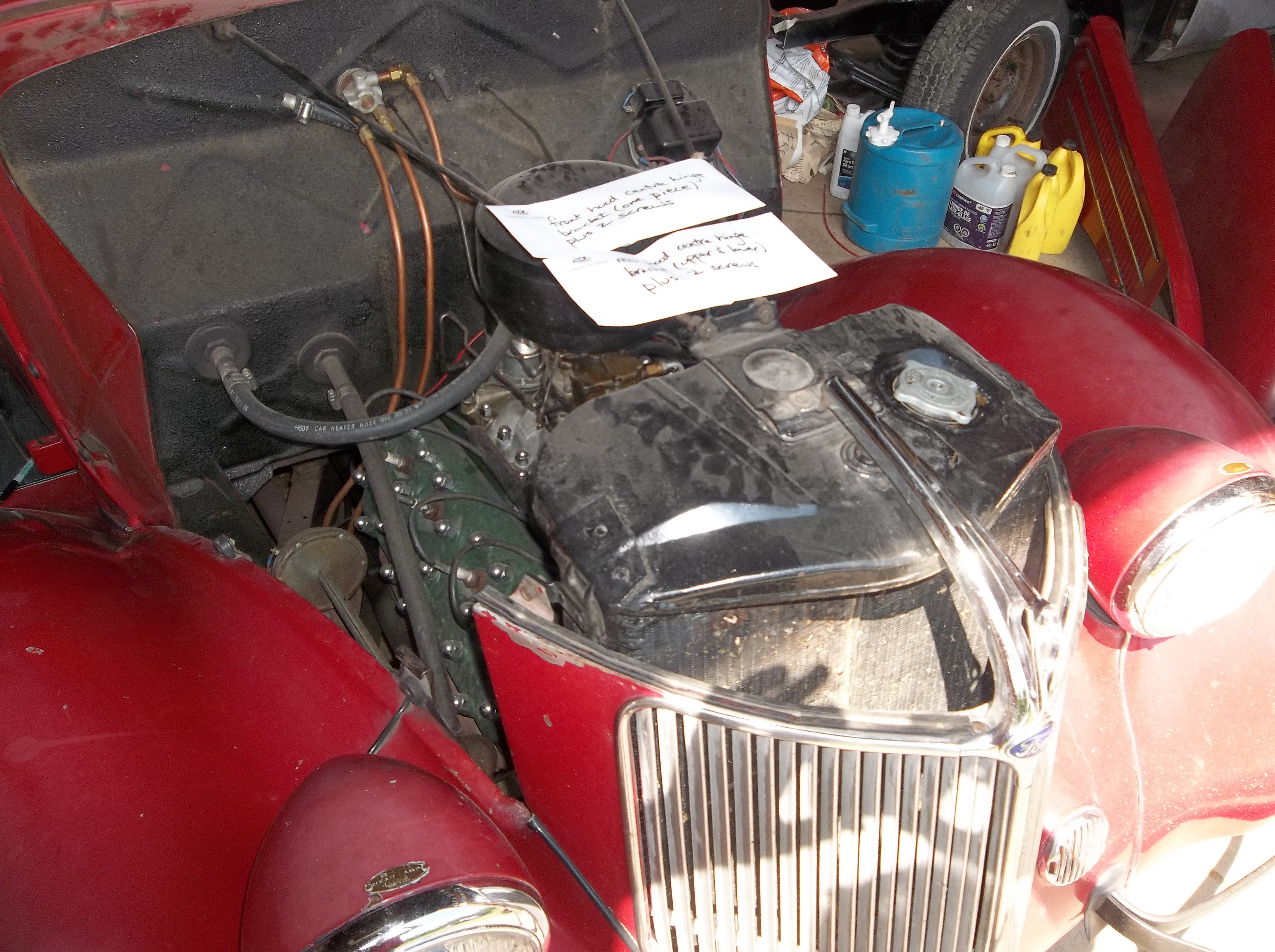

09-20-2018 @ 6:43 AM
Posts: 559
Photo 6 ......
The parts pile, with envelopes full of various fasteners.
Note the small green can of Pennsylvania lubricant at lower right. I found it to be helpful.
