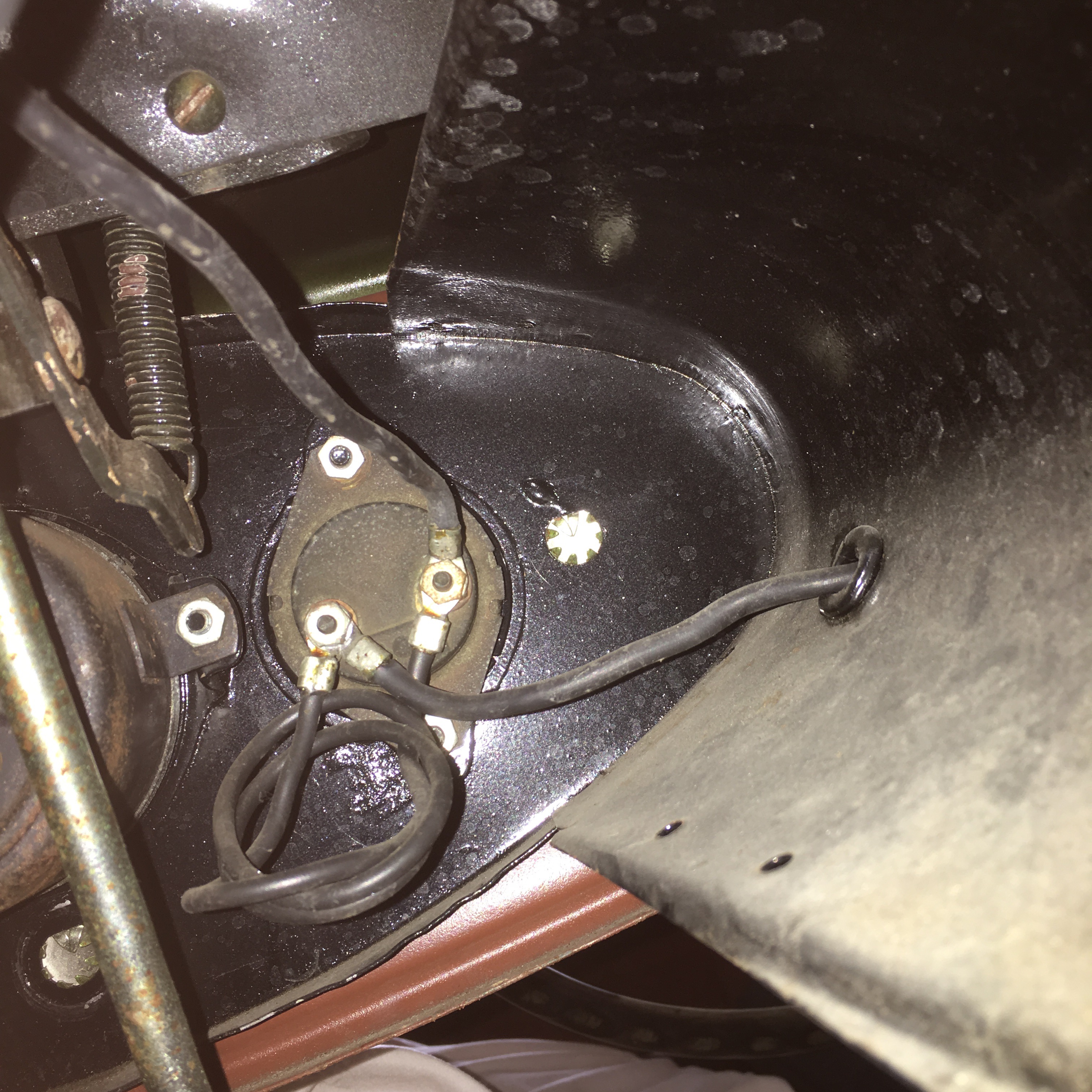

I would definitely go 12 volts negative. One of the advantages to going to 12 volts is that you can use modern electronics (cell phones, GPS, chargers, radios, jump starting from another 12 volt car, etc.). Another related comment is if you are using your original ammeter you can run a shunt across the two terminals to keep from damaging the ammeter with to many amps. Be sure to run a wire heavy enough to carry all of the current in case the ammeter fails. Volts are not the problem, amps are. See photo of the back of the ammeter in my '32. Some of the current will go through the ammeter and the rest around it. The reading will be low but you can't have everything.
