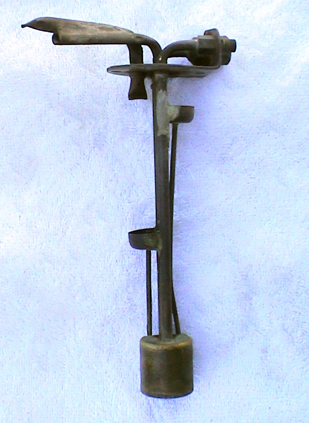

I would bet your new fuel line is connected to the hydrostatic sender as original since there is no where else to connect it on the 35 original gas tank. On the hydrostatic is a brass fitting for the fuel line. The other side of the fitting has a short fuel line soldered to the brass fitting. At that soldered joint look for a small crack in the lead solder. Any crack can make it nearly impossible for a good fuel pump to pick up and deliver fuel to the carburetor. The hydrostatic also has the fuel tank air vent tube which should be clear of any debris. Since the gas cap is Non-vented it's the only way air enters into the tank. Since you have to remove the hydrostatic to make any solder repairs, clean the vent tube and the other tubes you may as well clean it and repair any other broken solder joint. I have attached a picture of the 33-34 hydrostatic which is very much like the 35

ok i was wondering what that small line was used for, will have to look at it again, as for the vent on it i know it is clear, i put some air to the tank and it did leak from the back side of it
