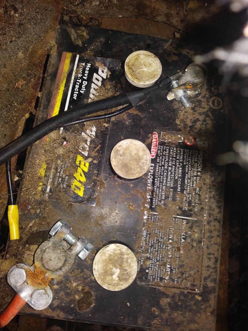

i read some on this in here, but here it goes.. first off i read that they are pos ground, mine has the neg ground going to the frame and the pos ground going to the foot starter and then to the starter, don't know if that is right but that is the way it was when i gotten it from my dad, and this has been sitting for 40 years now.. my biggest thing is i have a 1937 distributor and had no spark,cleaned the points up and had spark for a little bit but stop, so change out for the newer coil and top, gotten spark for 2 minutes and stopped again so changed the points and found out that it was my condenser, but what it is doing it eating them like candy.. im on my 5th one and they only last 3 minutes top... what am i missing or doing wrong?
TomO |
05-17-2018 @ 7:25 AM
Posts: 7243
First of all the car should be 6 volts positive ground. If it has been converted to 12 volts negative ground, you need a 12 volt coil. Second are you using an adapter plate to connect the coil to the distributor? Try using a NAPA ECH FA76.

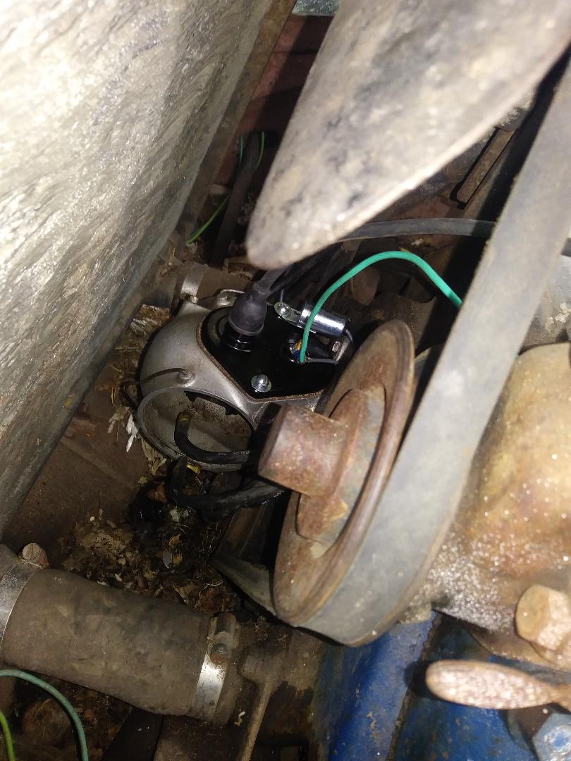

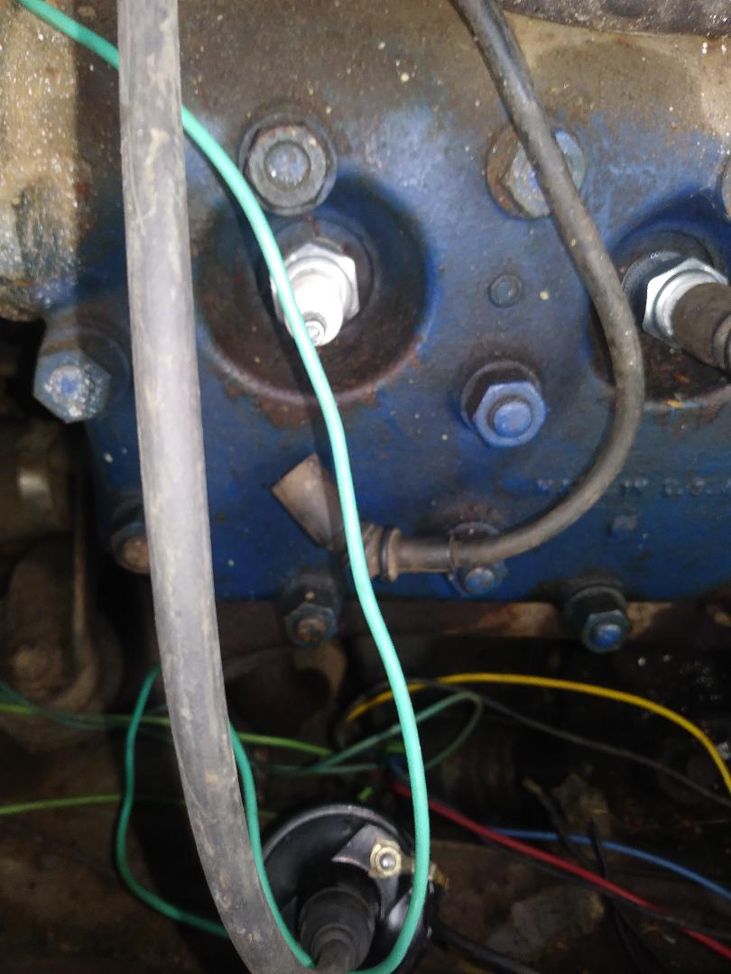

Garysr1966 |
05-17-2018 @ 1:49 PM
Posts: 24
Joined: May 2018
this is one i have on it... and it is a 6 volt battery

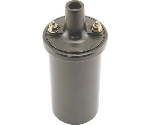

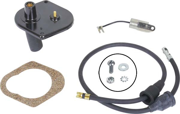

Garysr1966 |
05-17-2018 @ 1:50 PM
Posts: 24
Joined: May 2018
with this
