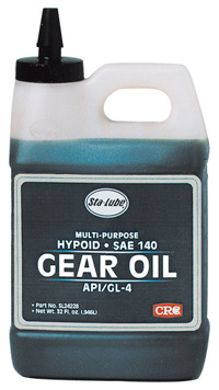

Hi, I been useing straight 140 wt. mineral oil is that ok to use in my 35Ford.Thanks again .s
supereal
04-02-2011 @ 10:42 AM
Posts: 6819
That would be fine. Sta-Lube makes excellent grease and oil. Most, if not all, gear lube today containes "high pressure" additives. There is nothing wrong with synthetic lubes, but old vehicles have wide clearances that require heavier consistancy. We tried synthetic grease in rear hubs, and it accelerated the erosion of the axle housing. Not everything new is automatically better.
parrish
04-02-2011 @ 9:31 AM
Posts: 349
Is this the good stuff for 39 trans and rear?
