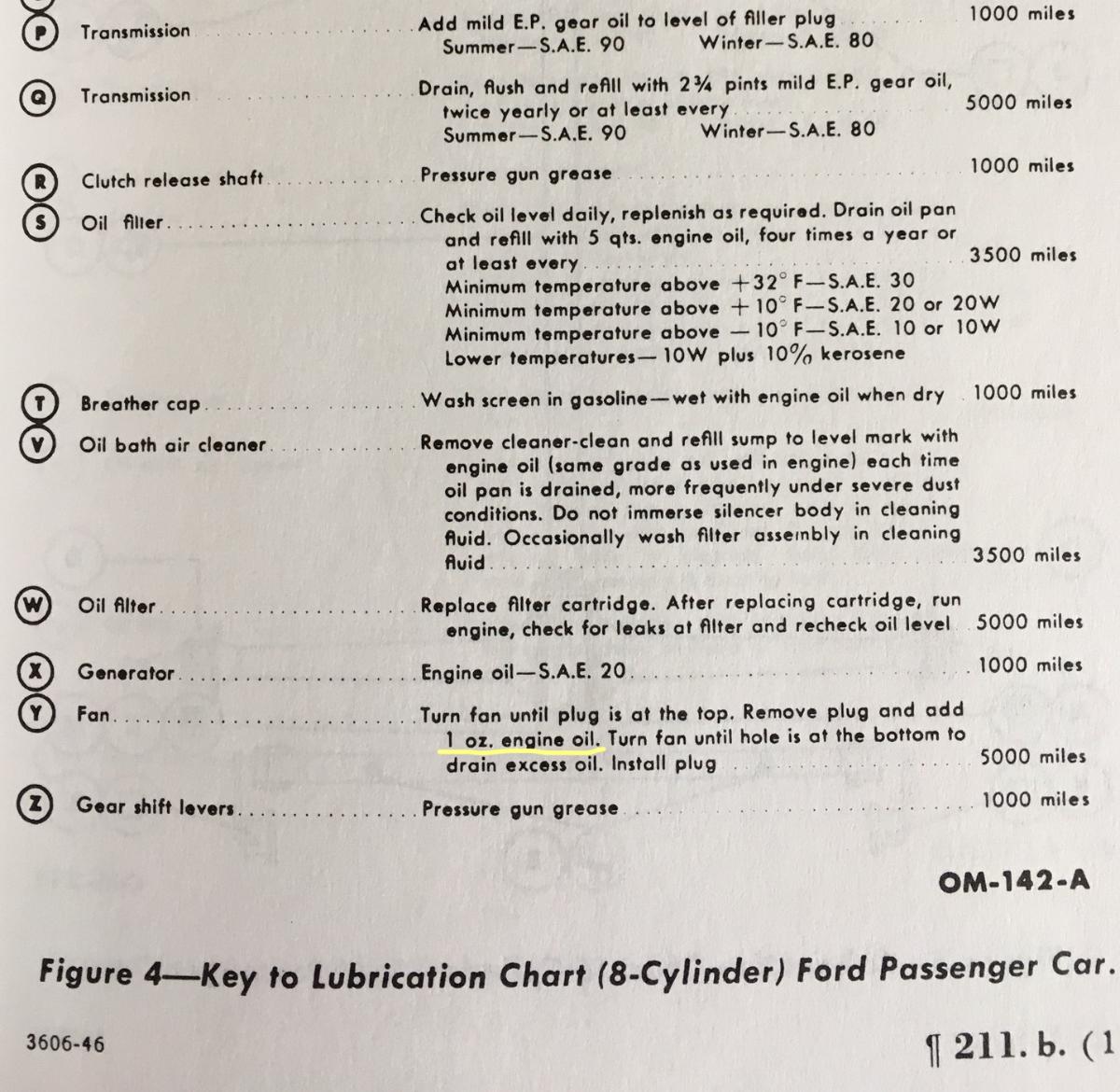

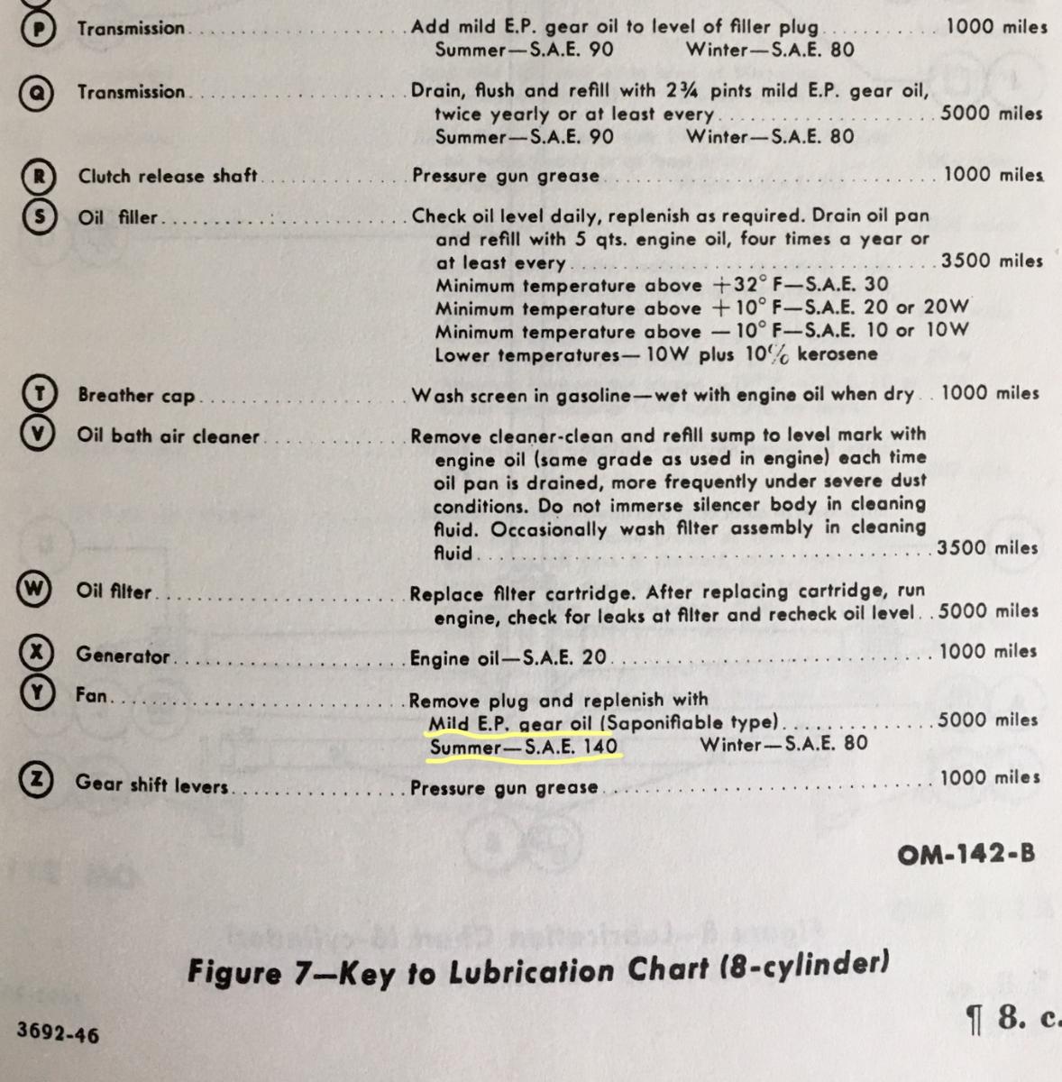

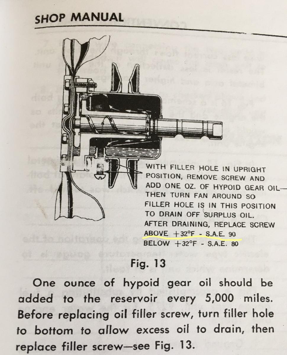

51woodie |
04-19-2020 @ 6:29 AM
I looked in three of my manuals, and came up with three different specs. I have a stock "46 Coupe, and based on umpteen opinions on the various forums, I decided to go with HD30 for my fan lube. Right or wrong, it works for me...so far. Attached are snaps from the three manuals I referenced, and I underlined the spec's that Ford gave at the time of printing.
