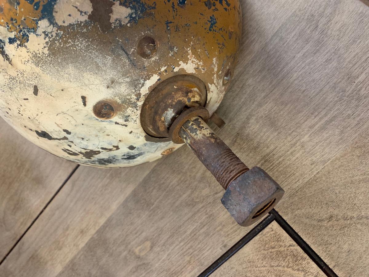

I have an old headlamp bucket that I need to clean the threads on the mount. Can anyone tell me what size tap to use on this? It seems to be an odd size.

It is an 11/16-18 nut. Found on page 531 of the Green Book.
I would use something like Evaporust and then a thread chaser to clean the bolt.
