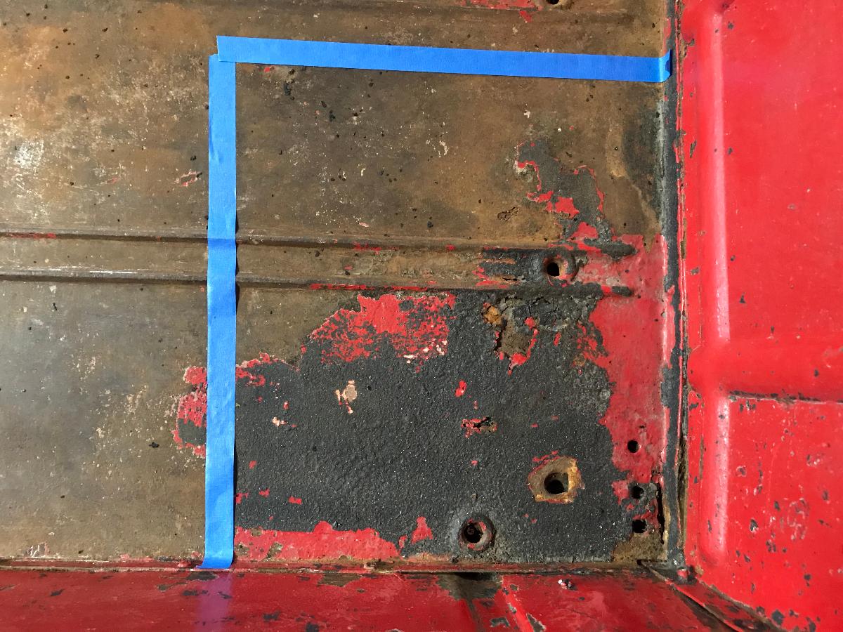

My new acquisition pickup needs sheet metal work o the front floor of the bed
First, is there someone who makes patch panel for this and since this bed was at one time removed and ‘reinstalled ?’ Is there any diagrams or information on correctly reinstalling the reinstallation.

The picture does look a little bad. Looking at the rivets along the edge it looks like it could be the original bed floor.
I would suggest you contact Mack Hils in Mobridge MO about a replacement floor panel, if you decide to go that way.

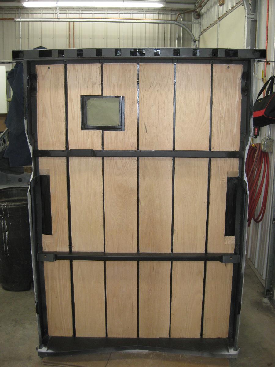

You will have to use a grinder to remove the rivets. As for the wood sub-floor, that was placed in the box frame before the end plate was attached, so that is another issue to deal with.
Here is a picture of my 1936 box that I purchased from Mack Hils. If you have the funds, a reproduction is the way to go. Yes, you will have to cut the carriage bolt holes in the front of the floor, and also the rear fender bolt holes, but as my body shop guy said -- to repair my original bed would have cost about twice what a new bed cost. And that was just in labor to straighten and weld.
