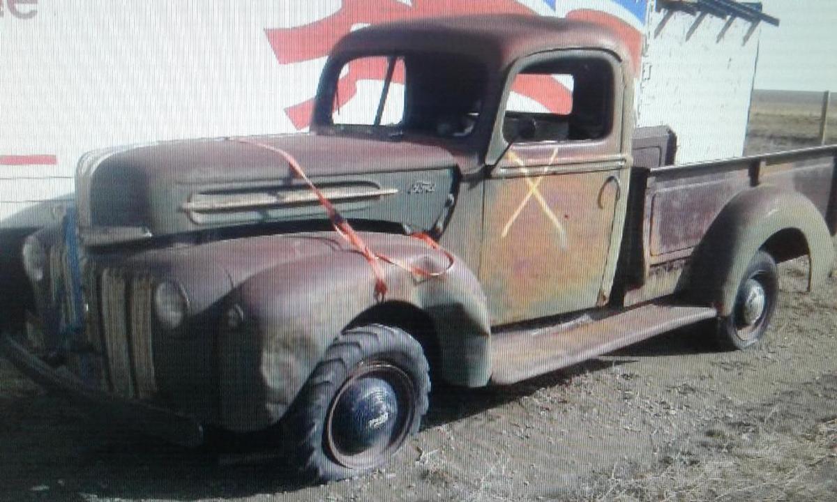

please do tell is anyone knows where i can find my vin #on what i believe to be a 1946 ford truck 3/4 ton

If 1946, this would be a half ton (Commercial) or 1Ton (Express Tonner) No 3/4 tons in 1946. Hard to tell for sure with those hubcaps, can you take a photo of the box from the rear?
Numbers should be on front of Left(Driver side) frame on top stamped into frame, no tag.
