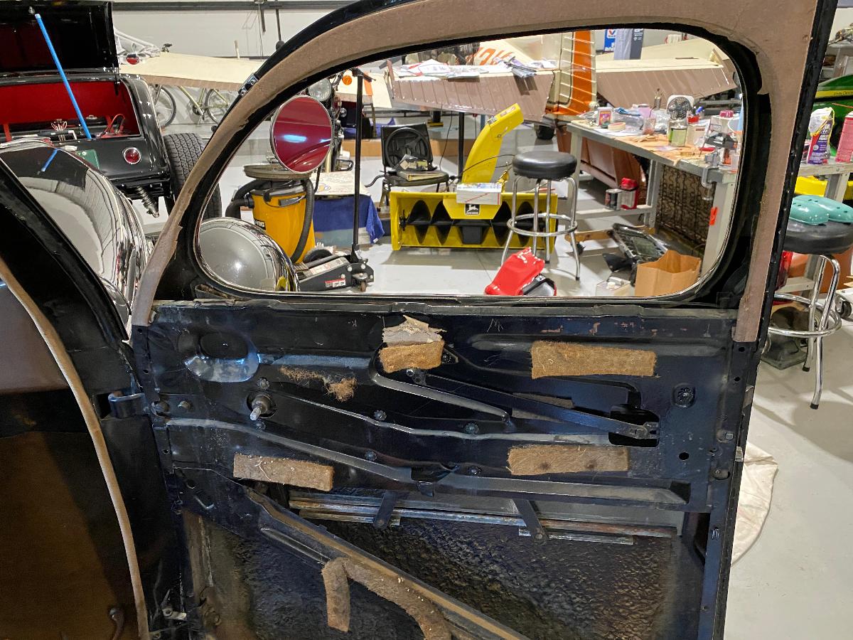

As detailed in another thread, I learned how to remove inside door window molding. I now need to remove the glass from the door. I need to detach the bottom glass channel from the regulator arms. Does anyone know if this is done by first detaching the regulator from the door?
Ultimately, does the glass come out the top or ??

Drop the regulator and glass down to the bottom of the door. You then slide the regulator off the glass channel. Take the regulator out of the door and then take out the glass.

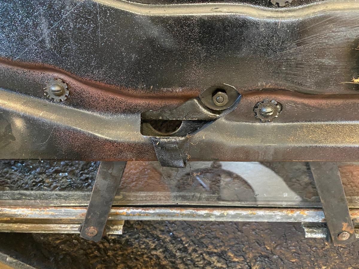

trjford8,
