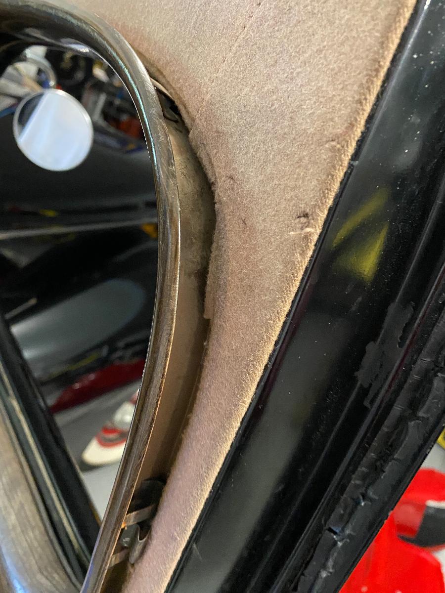

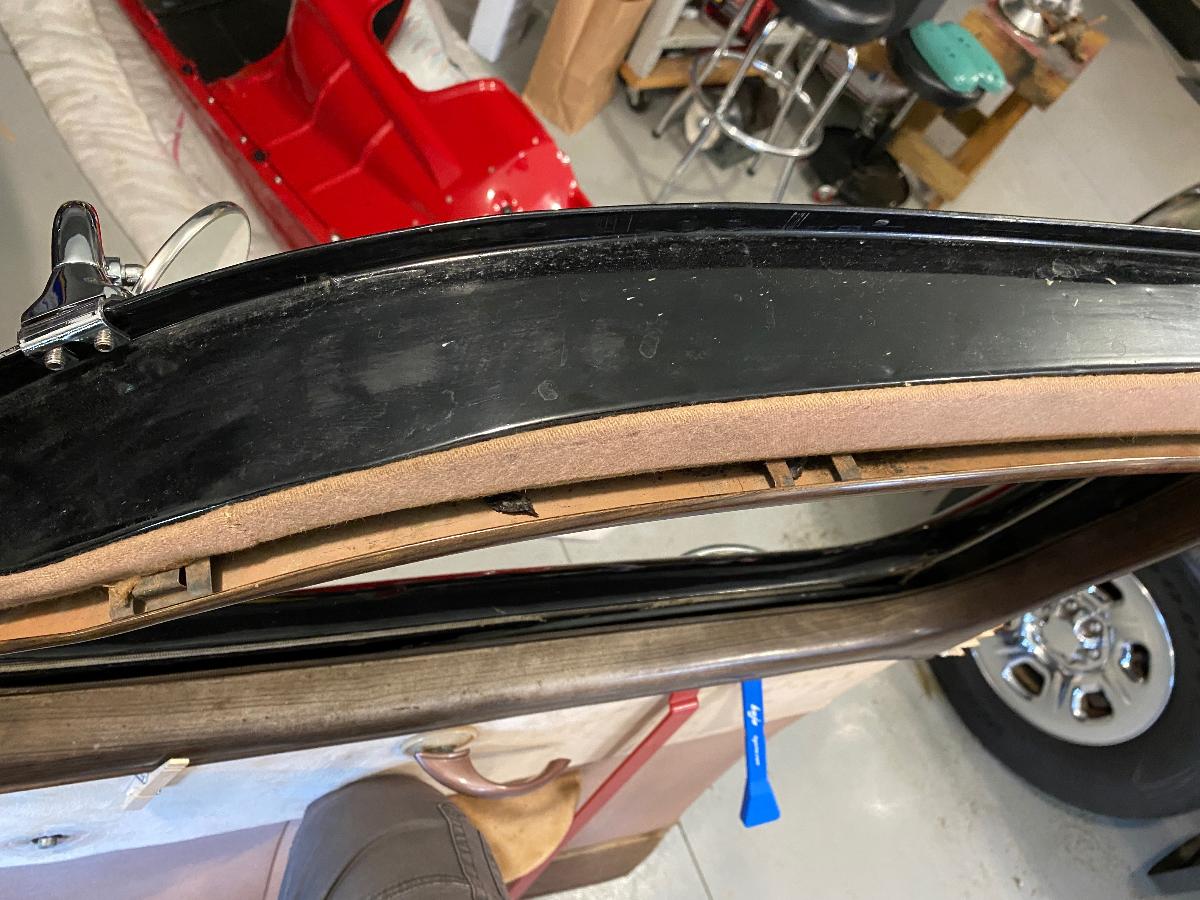

Another glass related question,...how does one remove door window garnish moulding?? I see no visible screws, do they snap on/off? I want to ask before beginning to pry on things.

Tom, I soooo wish that this molding was retained by screws, .... but it's Not. It appears to use some pretty strong clips to retain. I have manage to unsnap the top side, but the bottom not so much. I need to talk to someone who has done this before proceeding, don't want to damage the molding.

Well guys, I figured it out with some help from the fine folks over on the Ford Barn. After unsnapping the molding along the top and side, one tilts it out towards the inside. Then one taps the molding UP and off.
