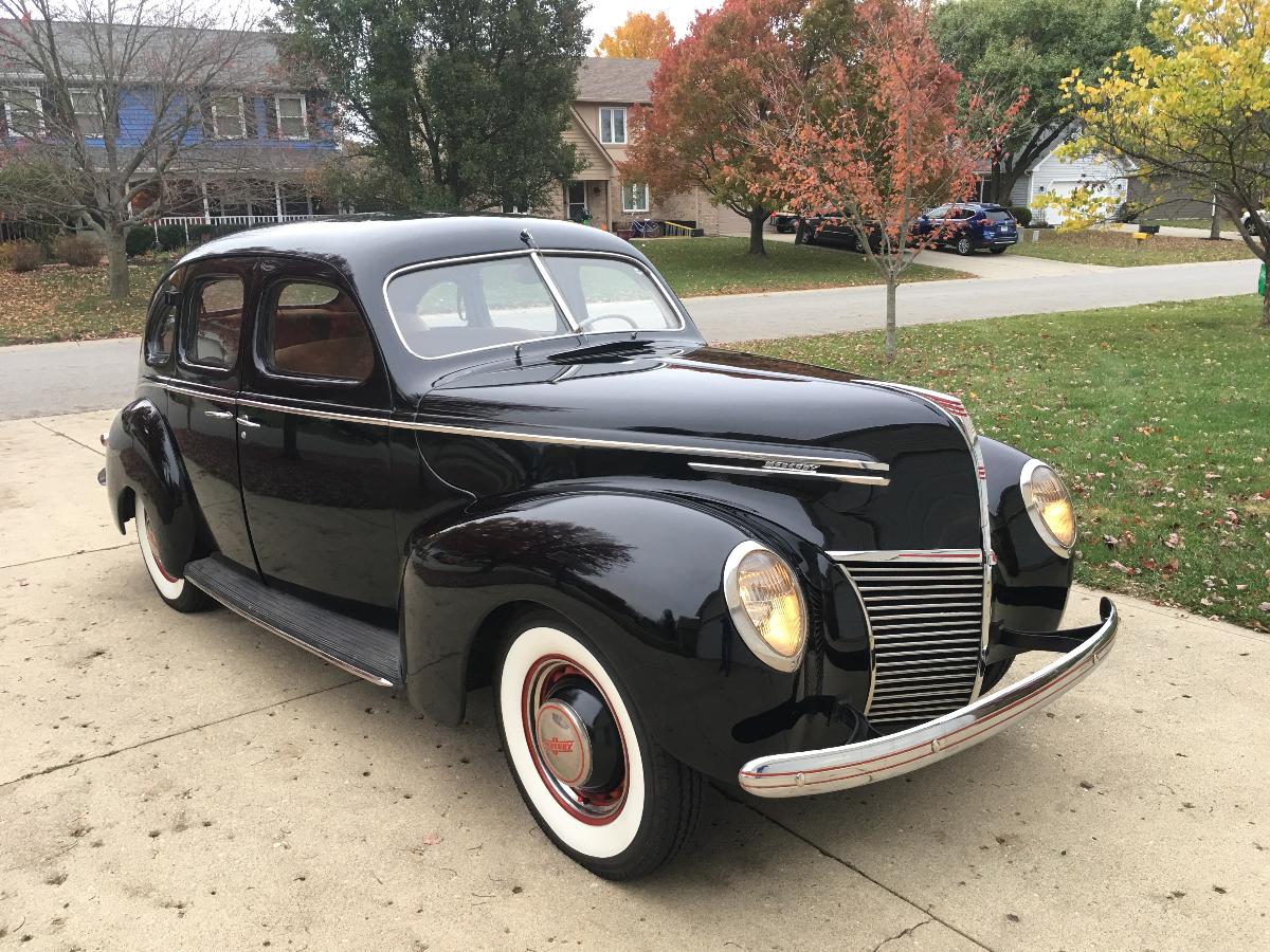

In the past few months I have serviced several components on my 39 Merc. It started with a leaking fuel pump. I installed a new pump plus a new carb and a coil and condenser from Skip Haney. I also corrected a problem with stalling by replacing my non-vented fuel cap with a vented one. Also spent some time and elbow grease cleaning and detailing the engine compartment. The car started and ran great. Today I tried to start it the engine cranks but will not fire. The only part I recently replaced is the Battery. I also replaced the braided positive ground to body cable with a more modern solid cable. No time today to troubleshoot but since I smell fuel in the carb, should I start with putting back on the braided cable? The next item could be the of/on switch? I originally posted this in the Ford forum and the response from CarCrazy confirmed my suspicion about not replacing my positive cable with a braided one was a mistake! I have not replaced it yet but plan to later today and will see what happens. Any other comments or advice is always appreciated. Thanks
