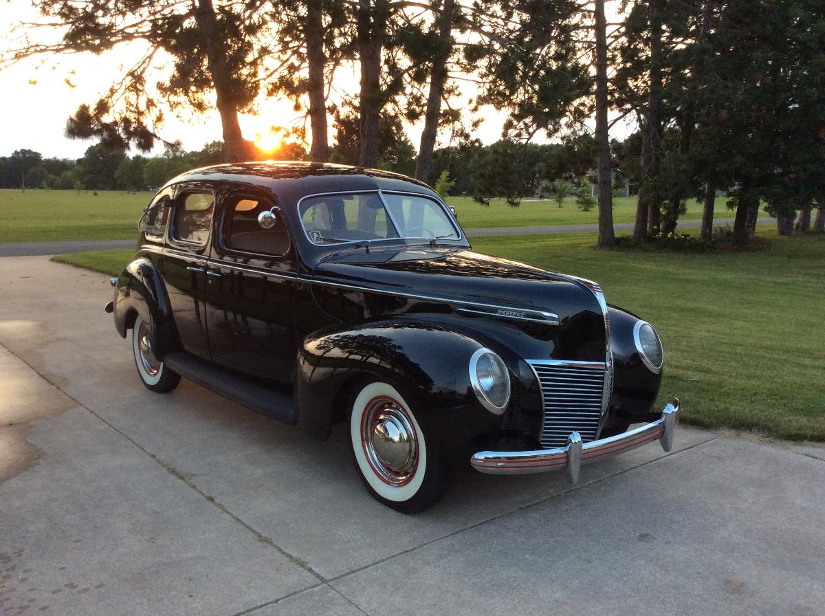

The trunk mat in my 39 Merc is all there, however so brittle that if lifted or removed it will become just pieces. That being said, I need to replace the gas gauge sender and am wondering if there is an access panel/hole in the trunk floor to get at the sender? Also, I have not checked the usual sources yet, but is the sender same as Ford? Thanks !

I love your 39 Mercury. It looks like it is in great condition. In addition to Bruce's comments: To check the float, remove it from the sending unit and submerse it in a pan of water that was raised to the boiling point and then removed from the flame. If it has a leak, you will see a stream of bubbles coming from the float. If the float is good and the sending unit does not register correctly on the dash gauge, the problem may be the contact points inside the unit. The top of the unit can be pried off and the contacts cleaned by spraying the contacts with tuner cleaner and operating the arm many times. Be careful of the fine hair like wires inside the unit. If you break one, it will have to be silver soldered. The arm on the 39-40 Mercury is the same as the 41-48 Ford and Mercury. The P/N for these sending units is 99A-9275. I don't know if the sending unit wire is long enough to allow you access to it if you drop the tank before disconnecting it. I have always disconnected the wire before dropping the tank. I had an original 1965 Cutlass with a rubber trunk mat that was hard and brittle. I managed to remove it and lay it upside down on a piece of hardboard. Then I used Gorilla Tape to tape it together and to reinforce it. It saved the mat, but you could still see the cracks.
