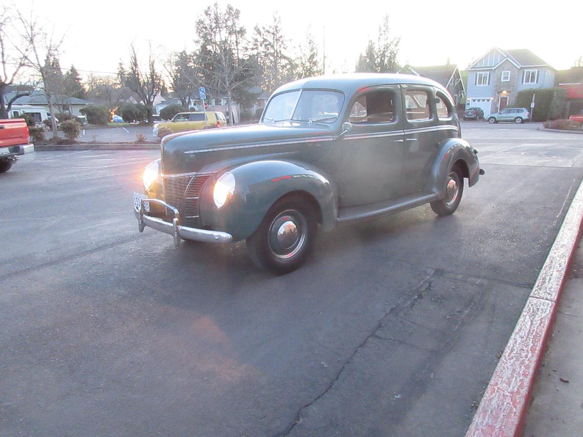

My original owner's manual emphatically states that regular lubricating grease should not be used on the springs but you should instead use Ford spring lubricant M-4628. What is acceptable to use these days ? My car is a Sedan Deluxe 1940. Thanks guys.

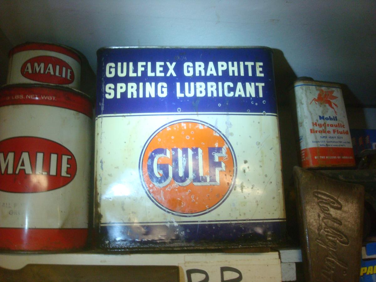

37RAGTOPMAN |
03-11-2024 @ 4:00 PM
this is what , they used back in the day, GULFTEX GRAPHITE SPRING GREASE, I think you can make this with grease has water repel and some graphite powder and mix them together and put in a special grease gun just for springs, JOHN DEER DEALERS, sell this grease for tractors. hope this helps 37 Ragtopman, Maine
