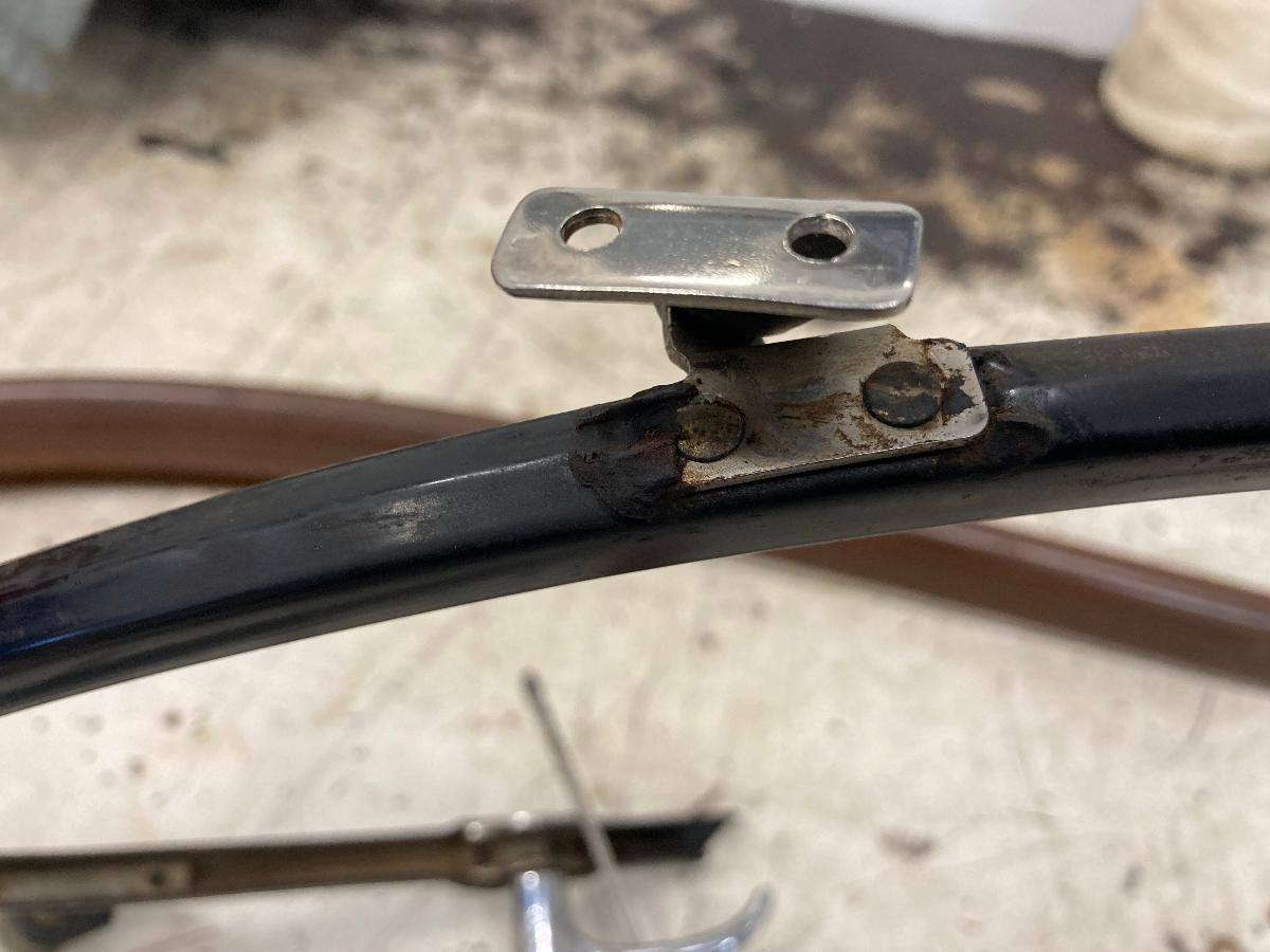

I am in the process of putting new weatherstrips, run channels and cat wiskers in both doors of my 1940 Tudor Sedan. I drilled out the rivets that hold the vent window weatherstrips and the upper pivot for the vent window frame. I removed the two rivets that attach the pivot bracket to the frame (see attached picture) and I believe this is going to cause a problem when I try to put it back together. The vent window weatherstrips came with rivets and after looking closely at them, I think I should have removed the rivet that the vent window pivots on instead of the two rivets on the frame. Do I need to put the upper pivot bracket back on the frame and remove the pivot rivet?

It has been several years since I replaced the rubber around the vent windows, so I cannot recall everything.
I drilled out the rivet that serves as the upper hinge point for the vent window. I am sure that I did not removed the rivets that hold the hinge to the frame or the garnish molding.
I did not find any plastic in the window regulator rollers/wheels.

After looking at the window frame and the weatherstrip, the only way to put the weatherstrip back on is to have the window pivot bracket in place so I will remove the window pivot rivet and reattach the braket to the frame. I found a picture of a window regulator and you are correct, there is no plastic on the rollers. Thank you for your help. Gil

I can sympathize with you doing that job. It's no fun. I recently replaced all four regulators and glass in my 1940 fordor. There is no plastic on the slides at the bottom of the window glass. There is only spring-loaded convex/concave washers that conform to the shape of the rail. Swallow many 'patience pills' before you tackle that installation. It's a puzzle.
