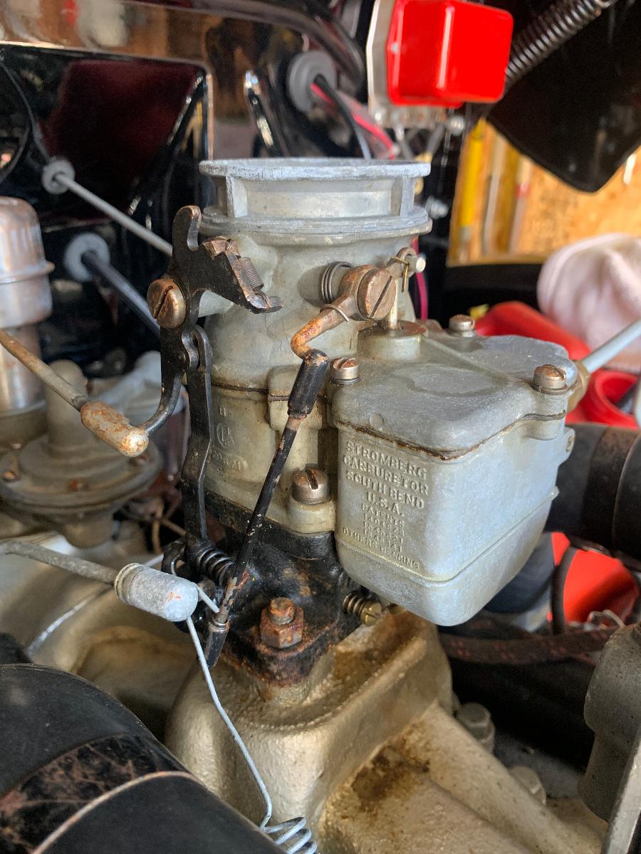

Update. I'm thinking it might be a fuel problem. I have a Stromberg 1 1/32 P20671 Carburetor....which I believe they say is a Stromberg 48.......any suggestions on a rebuild kit?

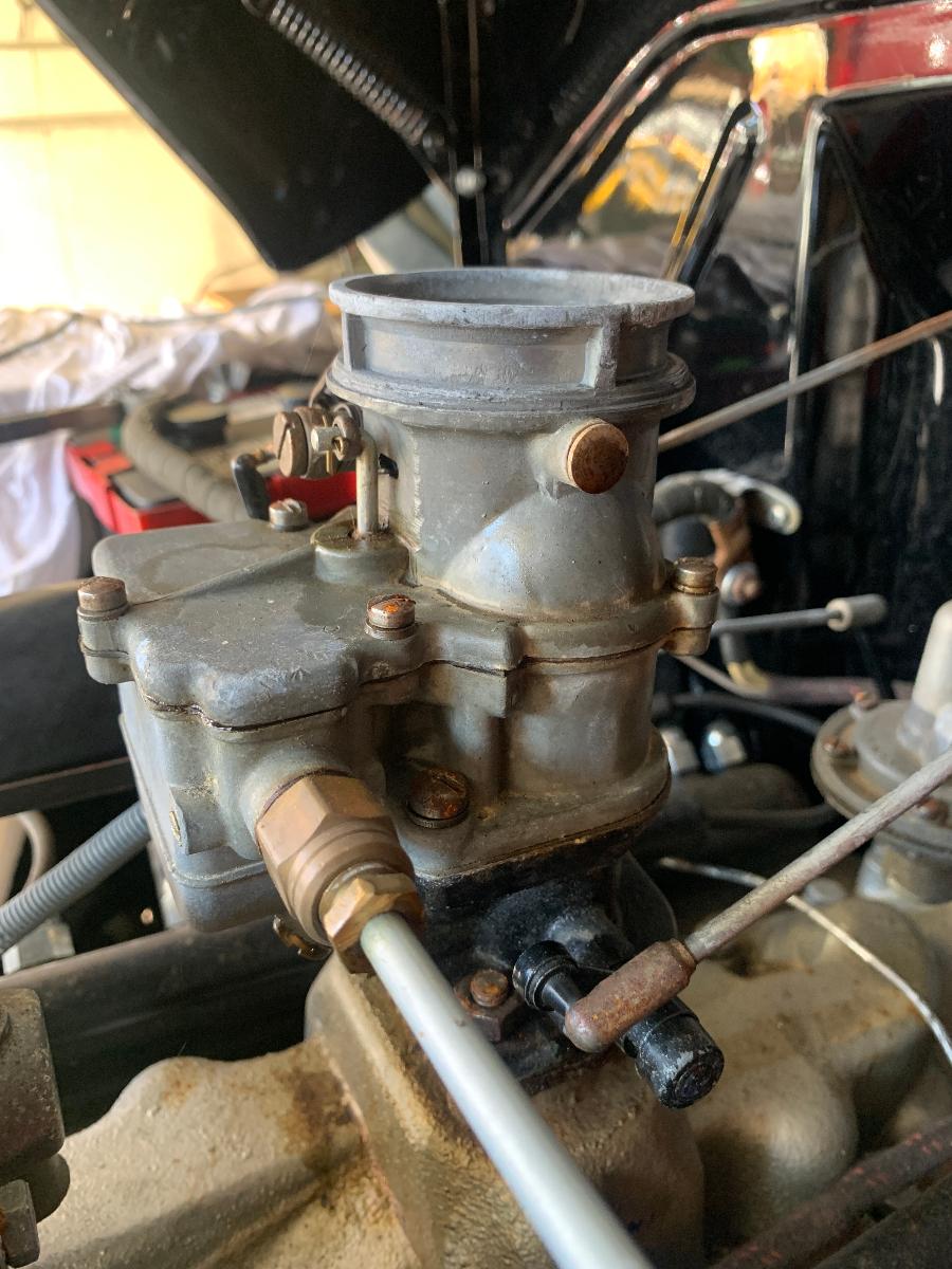

Update. I added a couple pictures of the Stromberg Carb.

For carb parts or repair if your truck does have a Stromberg Uncle Max is your man.
Max Musgrove
Info@97-express.com
435.322.0102
1173 South 1100 East
Salt Lake City, Utah
84105 U.S.A.
Next question, are you sure its a Stromberg and not a Holley? If its a Holley then Daytona Carburetor for a carb kit.
https://daytonaparts.com/
Another option if its a Holley is to send it to
Charlie Schwendler
716 662 9159.....cas5845@yahoo.com
He rebuilt the Holley 94 on the 8ba I have in my '39 p/u and it runs like new.
Good luck getting your truck running.

Thanks. I updated my pics and it is a Stromberg.

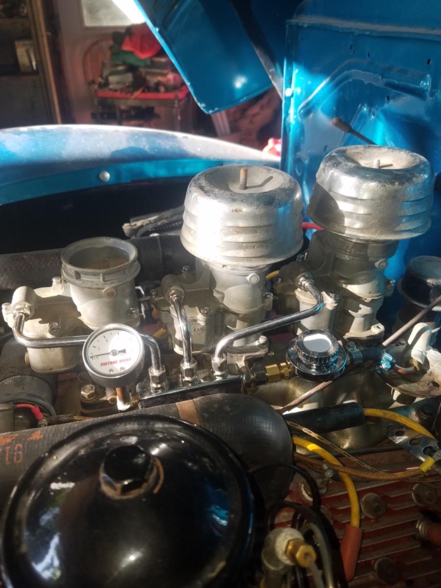

Btw, anything over 2.5 psi fuel pressure will force fuel past the needle and seat in the carb and give you a very rich idle. Also will push excess fuel past the rings and dilute your oil. If you are going to use an electric pump you need a pressure regulator and gauge.

I would suggest you get the proper Carb. for your vehicle rebuild and not the Stromberg. Originally the vehicle had a Holley or Ford 94 Model 91-99 Charlie Schwindler in NY is the rebuild person for this Carb and may be able to supply a proper core as well as rebuild, see the club rooster.
