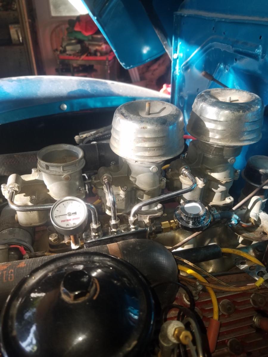

I have a unique problem. The rebuilt 41 v8 i purchased off from an engine stand years ago has 175# compression per cyl and i can't seem to get more than 13 inches of vacuum. I made my living as a mechanic and this smells of a cam and maybe it's been stroked. Any suggestions?

I bought this engine about 1990. I wasn't looking for an engine but i did want the dress up parts. At that time Aluminum heads and 3x2 manifold was about 750$. I was buying a repairable cab from this man when he asked if i needed an engine. It was on an engine stand wrapped in plastic and he told me it had been rebuilt about 15 tears earlier. I paid 650 for the engine. I have taken off the Weiand heads that it came with and replaced them with used Offy heads. I have hand lapped the valves and adjusted the lifters, so no carbon buildup The cam has no identifying marks behind the crab style distributor. While getting it to run I went back to basics and did a comp test 175# per cylinder! Also couldn't get more than about 13 inches of vacuum. I live in Michigan, so no high altitude involved. I have 3 two's on it but only the primary is active. The secondary' have both fuel and air blocked off. By the best I can figure I have a 41 engine.

Your low vacuum may be due to massive leaks at the manifold or the mounting surface for it. The manifold mounting surface may be warped enough to prevent a good seal. Do you have a stock intake manifold to mount on the engine to see if it corrects the vacuum issue? If so, it would be a good idea to install it with a new gasket to see what happens.
