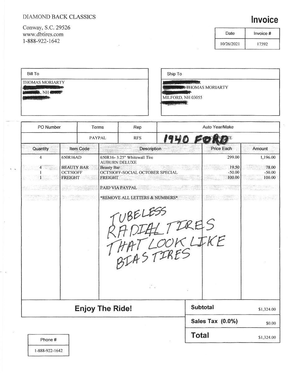

My recent purchase from Diamond Back (www.dbtires.com) Radial tires with bias tire look. Size 650x16 tubeless. Have not installed yet. Tom.
