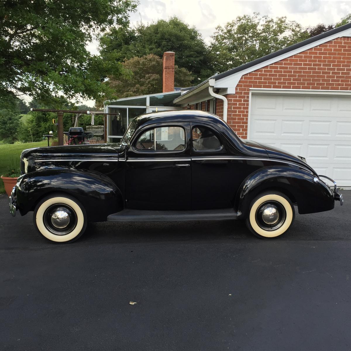

With the exception of driving lights and an additional brake light, I have a totally stock car. I'm interested in info on installing late model drum brakes to the front and rear so I can still use the original wheels. Ideally, I would like to remove the original parts and install something as close to "bolt on" as I can. I really dont want to start hacking on it. I dont mind searching and reading first, but the wording in my search attempts so far has not provided any info. Thanks.

Well, the brake conversion was done last week thanks to the information and comments provided by those who responded to my query. For anyone who is interested, and with the exception of the very limited modification to the stock spindals, this is as close to "plug and play" as you can get. It took a good mechanic about 3 1/2 hours to install them. I provided copies of the info and directions on the Boling Brothers site for the mechanic to review prior to doing the work. His only comment was that he was surprised they did not include a new set of lug nuts with the kit. I would have supplied them on my own had it occured to me. This is what I was looking for since I am trying my best to "upgrade" a few things without "major modifications". Due to weather and work I have only put about 40 miles on the new brakes. I was not expecting a significiant improvement in braking power, but the new system is light years ahead of what came on it. It also eliminates my responsibility for adjusting the brakes. I will say that even without being fully seated, their is a noticeable improvement. Even more important to me, I now have confidence in the braking system. Thanks again for your comments and suggestions.
