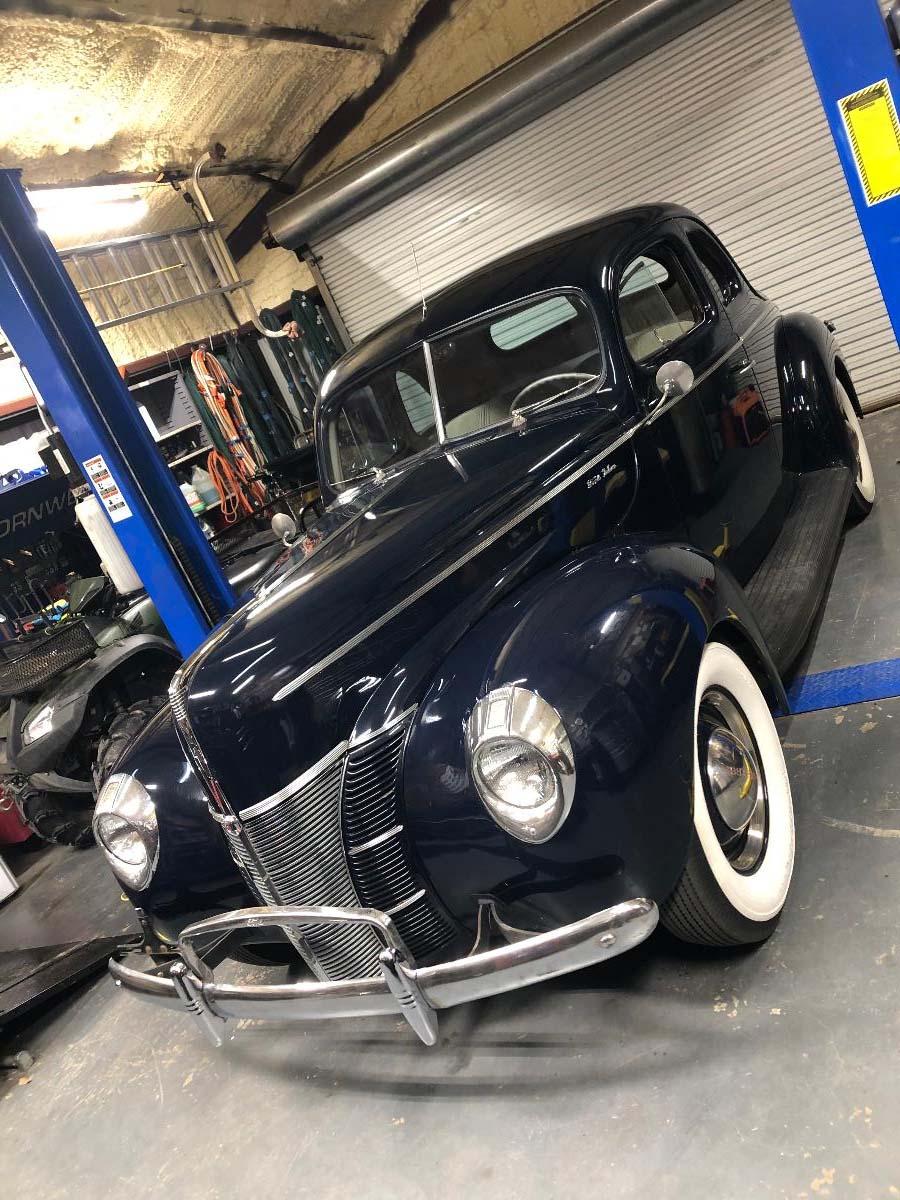

I have recently purchased a '40 deluxe coupe that is in very good condition. It has never been modified (with a few minor exceptions) and is just a good old driver. When I purchased it, it wasn't running due to weak spark. I bought a coil which solved the problem and now it starts quickly and runs well, good power and smooth until it warms up. After that it starts running rougher and has less power and stumbles when accelerating. The idle, however is still smooth but starts hard if stalled or shut off. Any ideas?

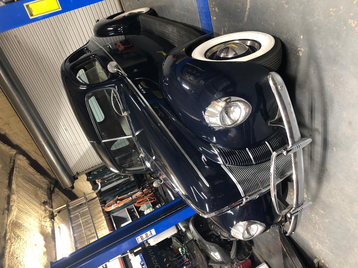

That is a nice looking coupe. Here it is right side up.
