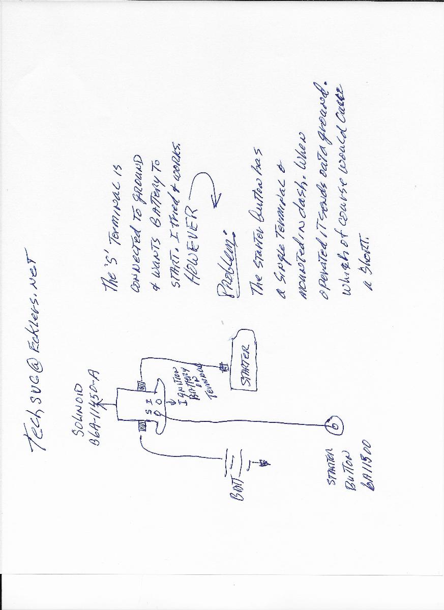

I just removed the starter foot operated starter switch and installed a solenoid on the firewall. All went well until I discovered the dash mounted starter button has one terminal and meant to send a ground to the solenoid. Well the 'S' terminal on the solenoid is meant for the switch but it is ground looking for battery. I tested it with battery and it worked. So you see my problem is with the starter button being a ground. What am I doing wrong? See attachment.

your problem is that you installed "a solenoid". You need a solenoid meant for an early Ford, the one you have is possibly for a GM or Chrysler.
03-26-2020 @ 7:27 PM
You can use that solenoid by installing a short jumper from the battery terminal of the starter to the I terminal of the solenoid and then connect the S terminal to the starter button. The Ford 3 terminal soenoid does thi with internal wiring. 14 gauge wire will work.

Joined: Dec 2009
