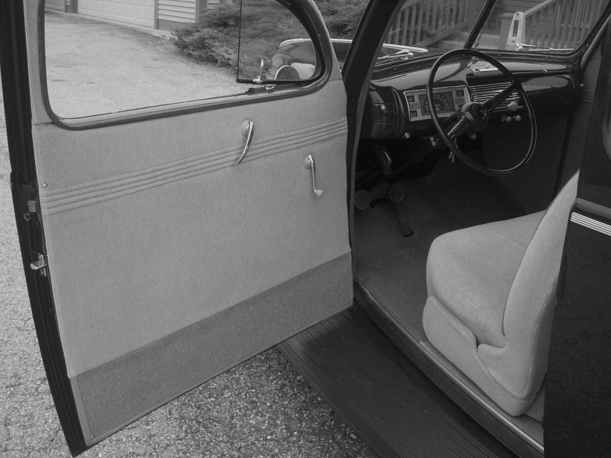

If I understand correctly, you'd purchased (just) the seals. That is, seals you must install within the stainless rocker trim.
I've attached a photo of one in place.
If available, I find it much easier to purchase these stainless trims with the seals already installed.

Thank you. Picture perfect ! !
BIG price between just the seal and the assembly.....
