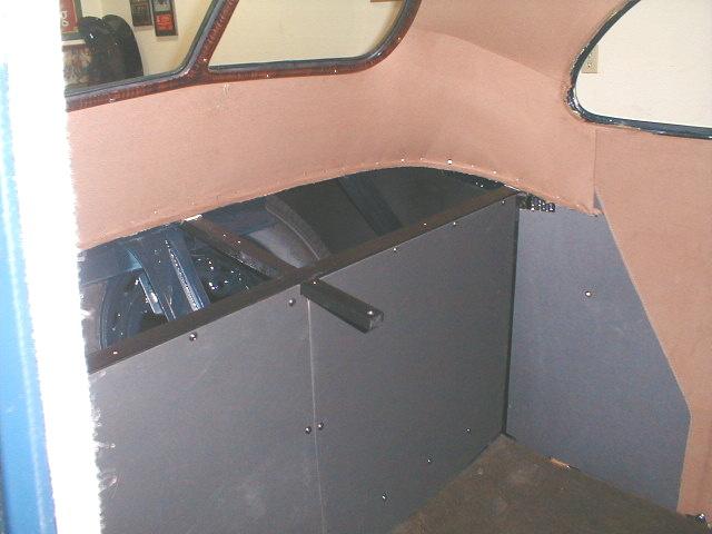

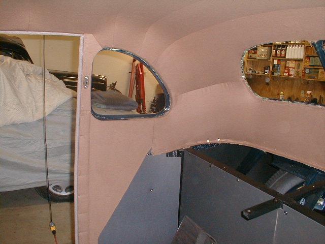

Mike, is removing the front and rear windshields also true on a '40 coupe, to install the headliner? I may be missing some subtle points as I saw in another thread that the headliner gets glues around the quarter windows and rear window frames, where I thought there was supposed to be tack strip - the glue install seems more reasonable to me and if you / someone could confirm I'd appreciate it. The package shelf appears to be a place where I might add a tack strip to secure the bottom of the headliner in the rear, below the window and to either side as the metal frame curves around, true?
kubes40 |
02-10-2024 @ 5:27 AM
Posts: 3370
The headliner, for a first-class installation, is best glued to the surface that the glass / rubber gasket will be placed atop when reinstalled. Easy enough to do this way and a much stronger (read: long lasting) installation. In regard to the area surrounding the package tray...I have attached a couple of photos of one of the coupes I'd restored. A tack strip in that area is necessary and was there authentically. I use the modern nylon type as it holds the staples better than the original twisted paper material.
