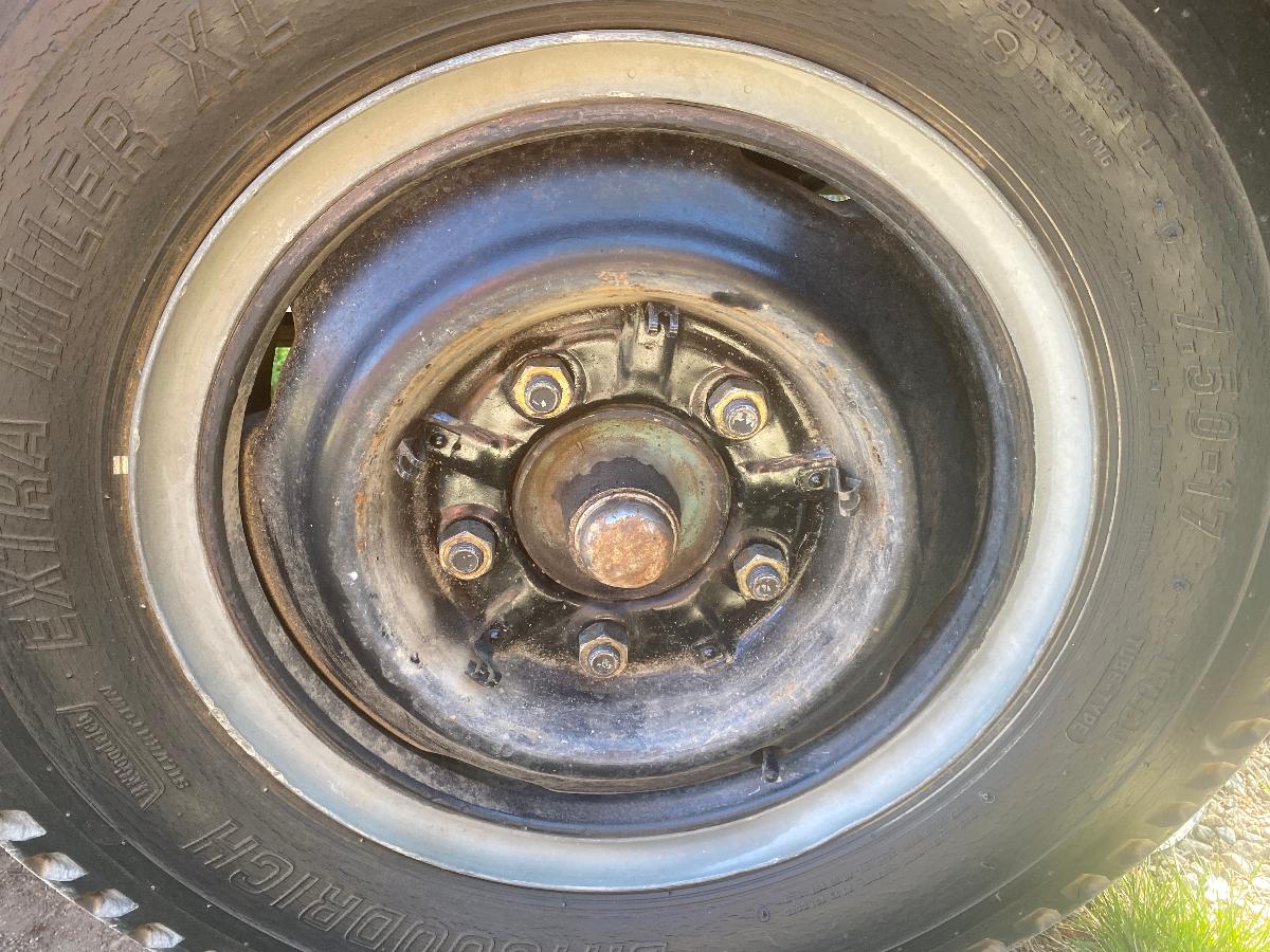

Stu this is a picture of my wheel . I am just trying to make sure I have a wheel that is not going to hurt the guy I find to swap the tires out.

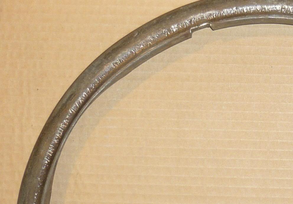

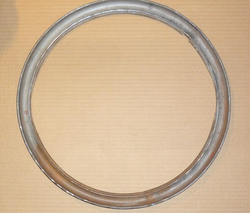

Yup, that’s a Tonner wheel. The ring has two indented areas on opposite sides that allow it to be squeezed over the lip of the base rim. Too much aggression in an effort to force it past the rim can bend the ring, so another reason to make sure the guy doing the work knows his trade. Obviously finding replacements isn’t easy. Below is a ring showing the indented areas. Stu
