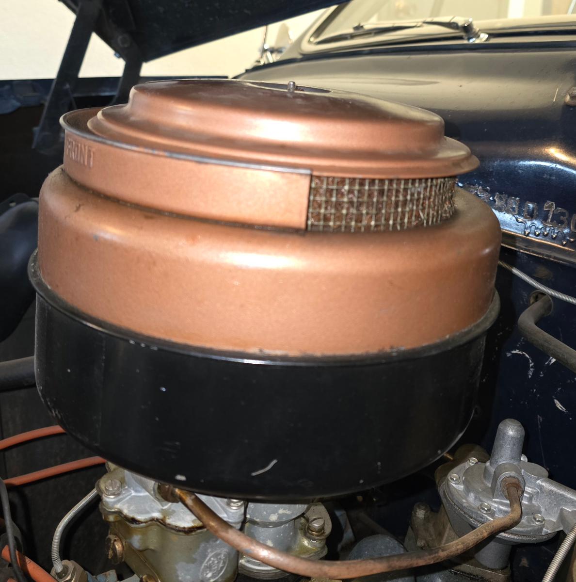

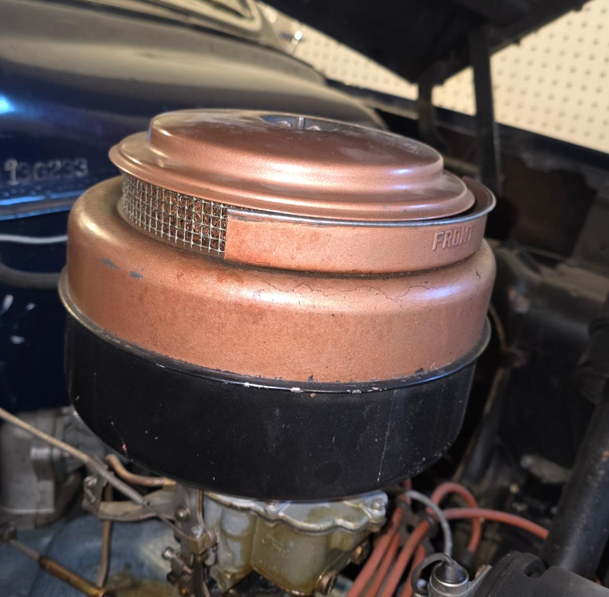

I have a '50 Custom Club Coupe with an 8BA. It has the air maze filter which looks nearly identical to the oil bath type. I have a few questiions. 1-The Shop manual is very brief in describing a cleaning method for this filter. Just clean copper mesh at top with kerosene, let dry, soak in motor oil, let excess drip off and replace. That's it? Is there any other filtering going on in this other wise large canister? 2-How is this attached to the carburetor? Mine almost seems to simply be resting on the carburetor, as I can turn it around and jiggle it a bit. I can not lift it from the carb however. There seems to be no bolt with a hand screw type loop sticking out to the side as I've seen pictured on oil bath type filters. I feel that it should be tight to carb. 3-Is it possible to replace the copper mesh with an actual paper or foam type filter of the same dimensions? Thanks for the help.

The answers to your questions are:
#1. Yes, the shop manual instructions are correct and no, there is no other filtering going on inside the large air cleaner housing.
#2. The air cleaner is attached to the top of the carburetor by a clamp which is tightened by a long handle that normally protrudes beneath the air cleaner toward the front of the carburetor.
#3. Yes, it is possible to replace the copper mesh with a pleated paper air filter which will provide more effective filtering of the air entering the engine. To determine which air filter element to buy, simply measure the O.D., I.D. and height of the mesh filter you have and get a pleated paper filter of the same dimensions. You can also take your mesh element to a full service auto parts store, like NAPA, to have the counter person locate a paper filter of the correct dimensions. One source for the paper air filter elements of various sizes is Speedway Motors.
