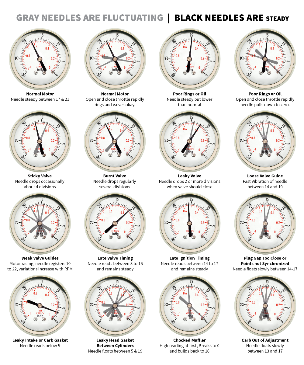

I also recommend getting/having a vacumm gage as it can indicate other concerns such as a sticky valve, manifold leak, etc. The one I have can also test fuel pump pressure.

A vacuum gauge is probably the most important diagnostic tool you can have. You can easily use it to determine the health of the engine.
It is easy to use, simply connect it to the port on the intake manifold that feeds vacuum to the windshield wipers. If the engine shows a steady intake manifold vacuum reading of about 19 inches at idle speed, the engine is operating properly.

51woodie
07-17-2026 @ 3:09 AM
Posts: 579
Here is a chart that interprets the engine vacuum gauge readings, that aid in troubleshooting engine performance issues.
