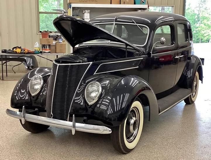

I have a 1937 Ford Model 78 Fordor that I removed the radiator, Distributor and Water Pumps from. Radiator has been professionally cleaned and tested and Skip Haney is rebuilding the distributor and water pumps.
Best place to purchase the Clutch, Pressure Plate and Throw-out Bearing?? Anyone know size of the Clutch in my model or do I need to wait until I take it all apart to find out?
What is best way to do the job? Pull engine with transmission or just pull transmission by itself?
