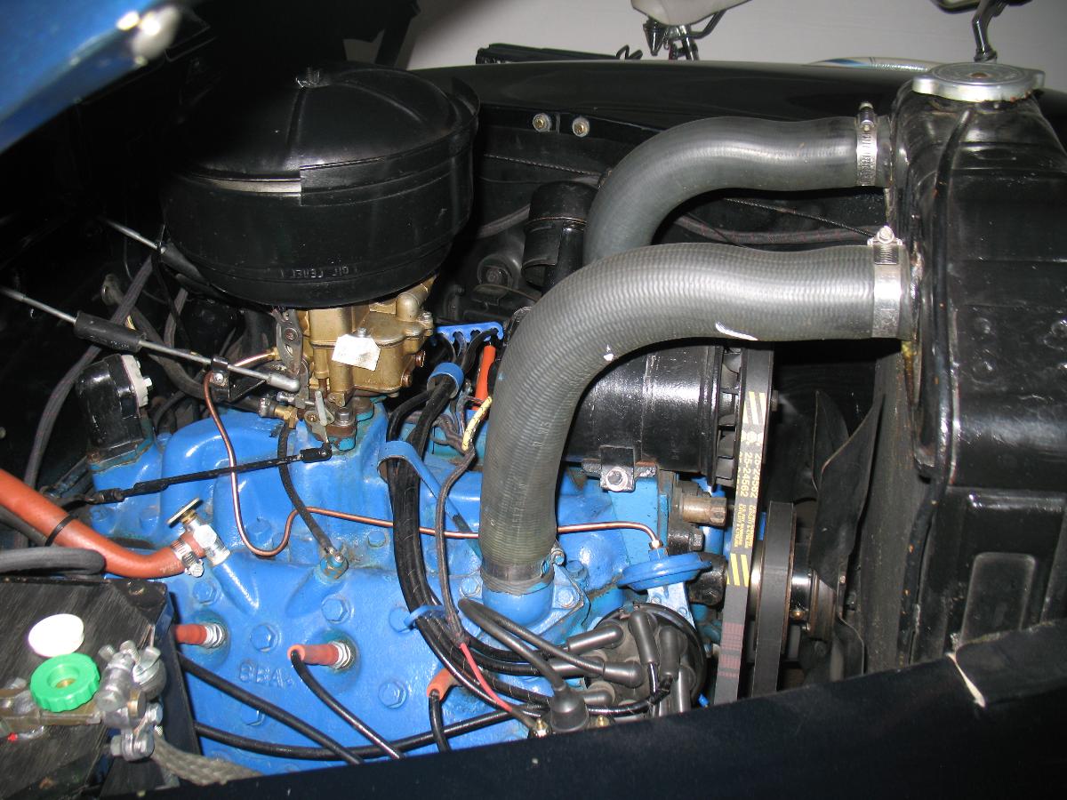

I have a 1946 Super Deluxe coupe.
See attached photo
The radiator hoses attach to the front of the heads, whereas I believe in 1946 they attached at the middle.
is there a fast and easy way to determine the year of my engine?
The numbers on the drivers side frame and top of the trans are no longer readable.
Thanks..

Your engine is not original to the car you have. The 8BA Flathead engine in your car dates from 1949 to 1953
