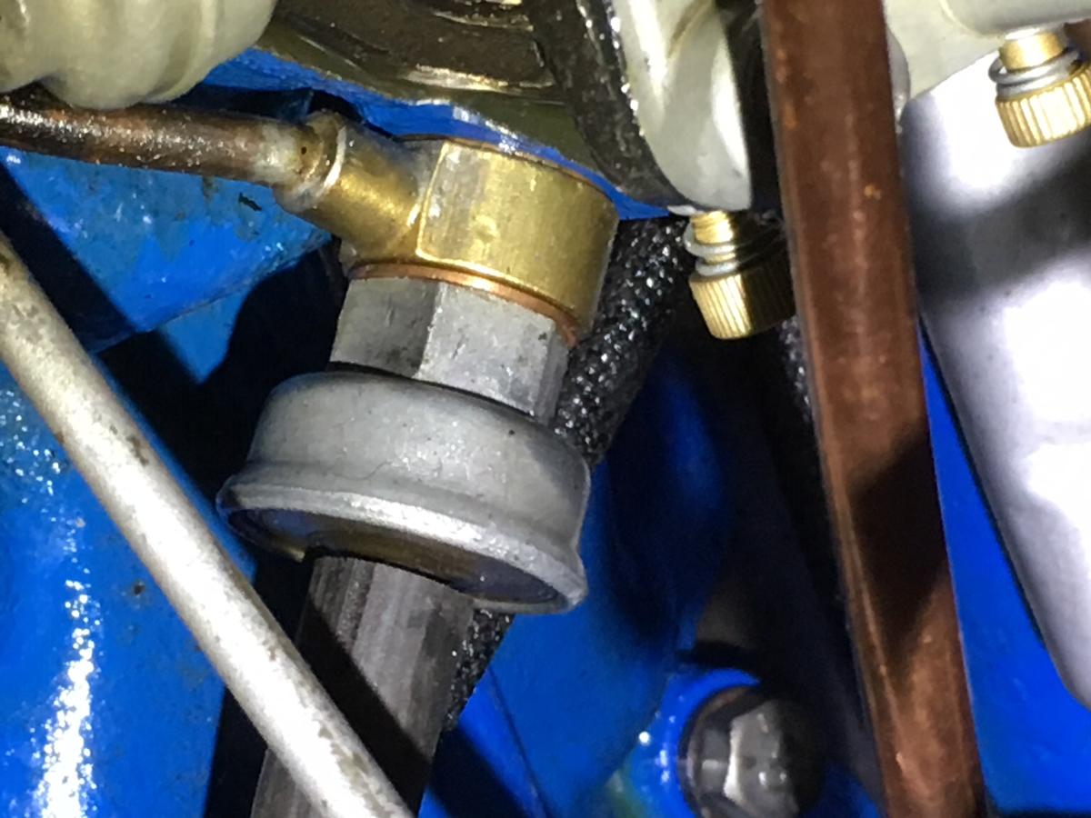

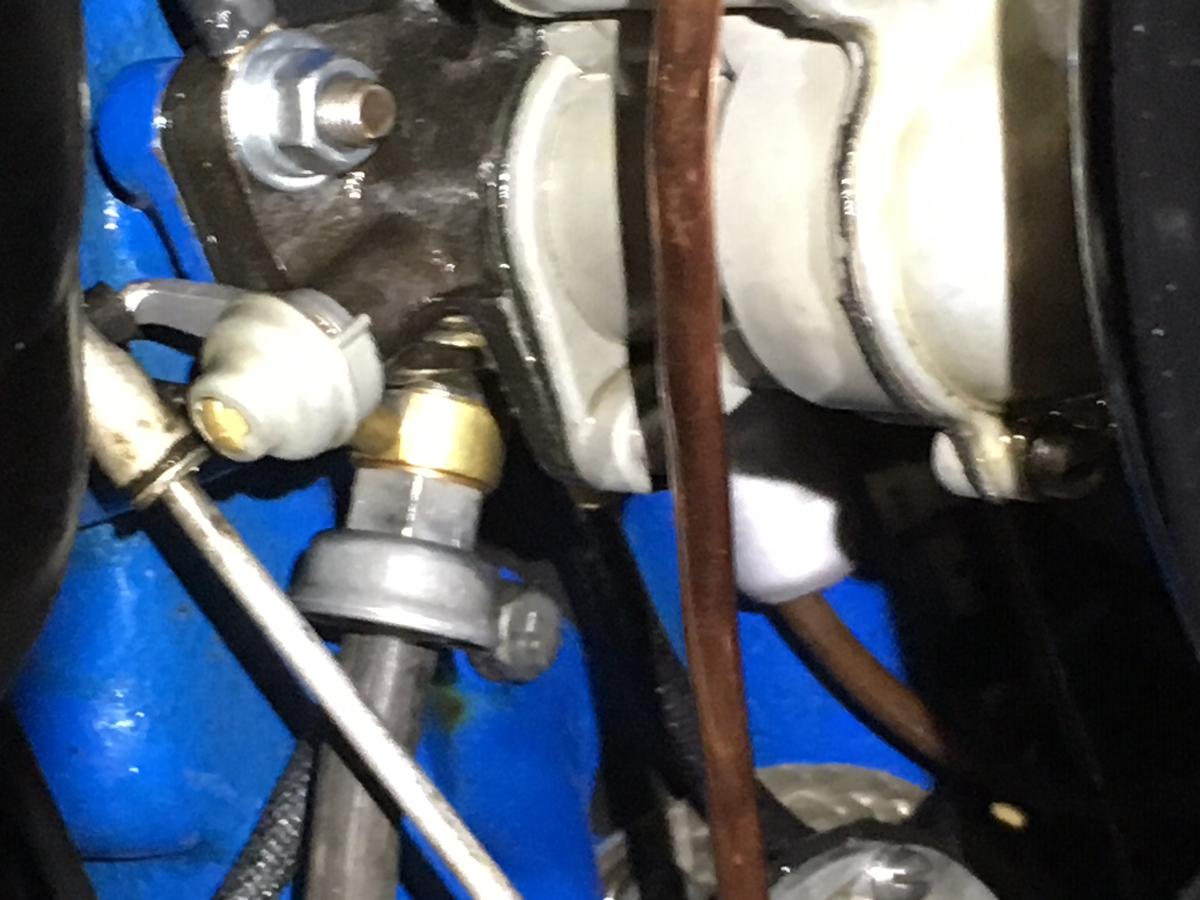

Here is where the vacuum for the distributor and the wipers connects to the manifold, on the 59AB engine in my '46 Coupe. The metal line goes to the distributor, and the rubber hose goes through the firewall, then connects to the wiper switch (valve) on the dash.

I would pull the rubber line off the wiper motor and attach a vacuum gauge and see if you have vacuum before taking things apart
if you have vacuum then see if there is a clog in the line, in the photos it looks like a one way valve, [tin can]
maybe it is stuck, it is broken, it also maybe dirty, if you remove it, maybe you can check the vacuum with out the valve in place, you might have to rig a fitting, to check the vacuum

The (tin can) that 37ragtopman referred to in the picture, is actually called a silencer. The one on my '46 Coupe, 59AB, is straight through, with no check valve. The part number for this item is 11A-17595.
