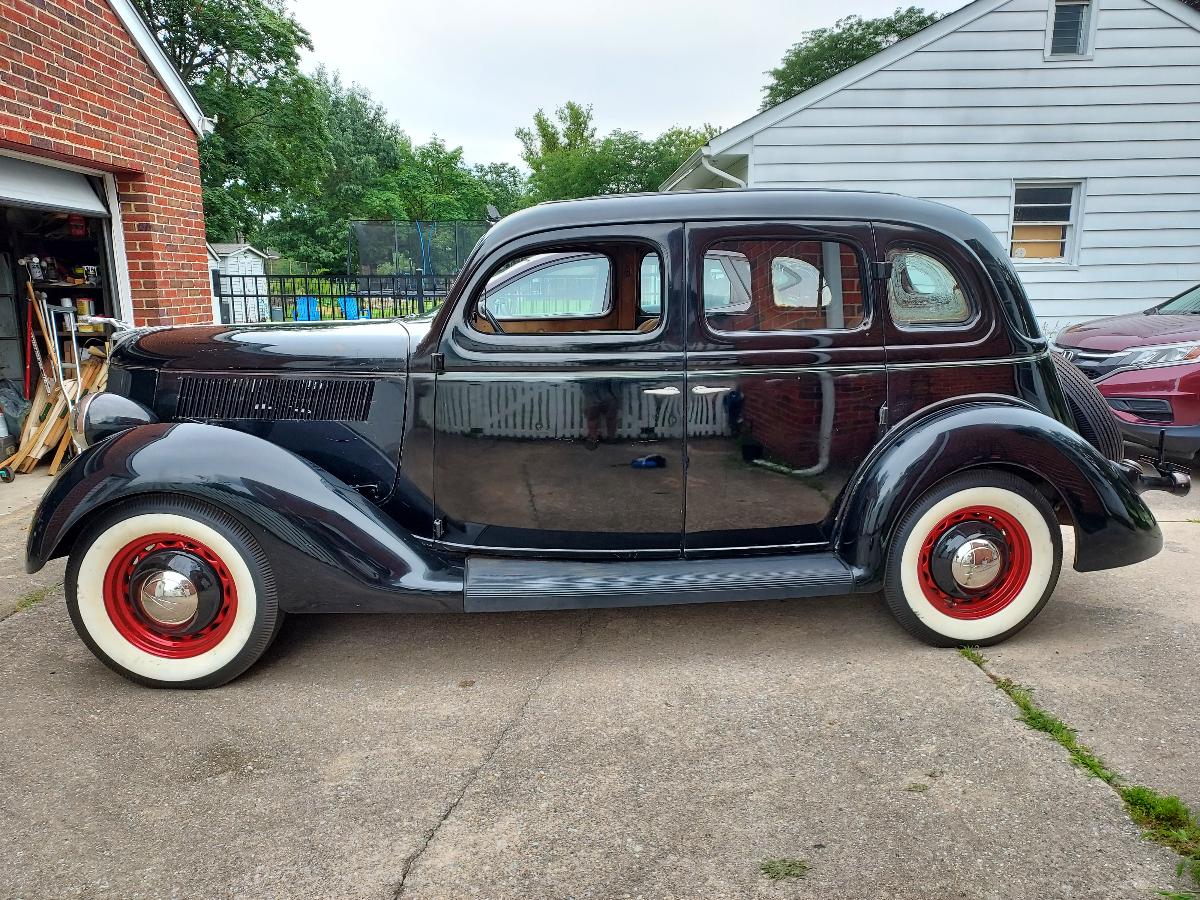

Tonight, my wife, daughter, and I took a drive in our (new to us) 1936 Model 68 Fordor. We had some overheating problems when the initially got the car, and we did a radiator and block flush to try to mitigate those issues. So far - fingers crossed - it looks like the temp issue is improving. We just took a 30+ minute drive with idling in traffic, and the temp gauge never got out of the normal range.
HOWEVER - the reason for this post - just as we were turning back onto our street after a successful test drive, the car started to make a thumping noise that seemingly came from the front wheels. It reminded me of the noise of driving on a flat, but the tires are all fine. We only drove about 150 ft, as it started right as we turned off the the main road toward our driveway. The thumping seemed to keep pace with the speed of the vehicle. I visually inspected the wheel, tires, underside of the car, and nothing stood out to me as dragging or broken.
Could this be a wheel bearing issue? Something with the brakes?
I am brand new to all this. I'm also admittedly not a gearhead, so this is all very new to me, and I am getting a lot of OJT when it comes to this car and cars in general. I apologize if my question is novice-level.
Thanks very much, John
(Photo just include to show the car. It needs some work, but it is about 75% there)
