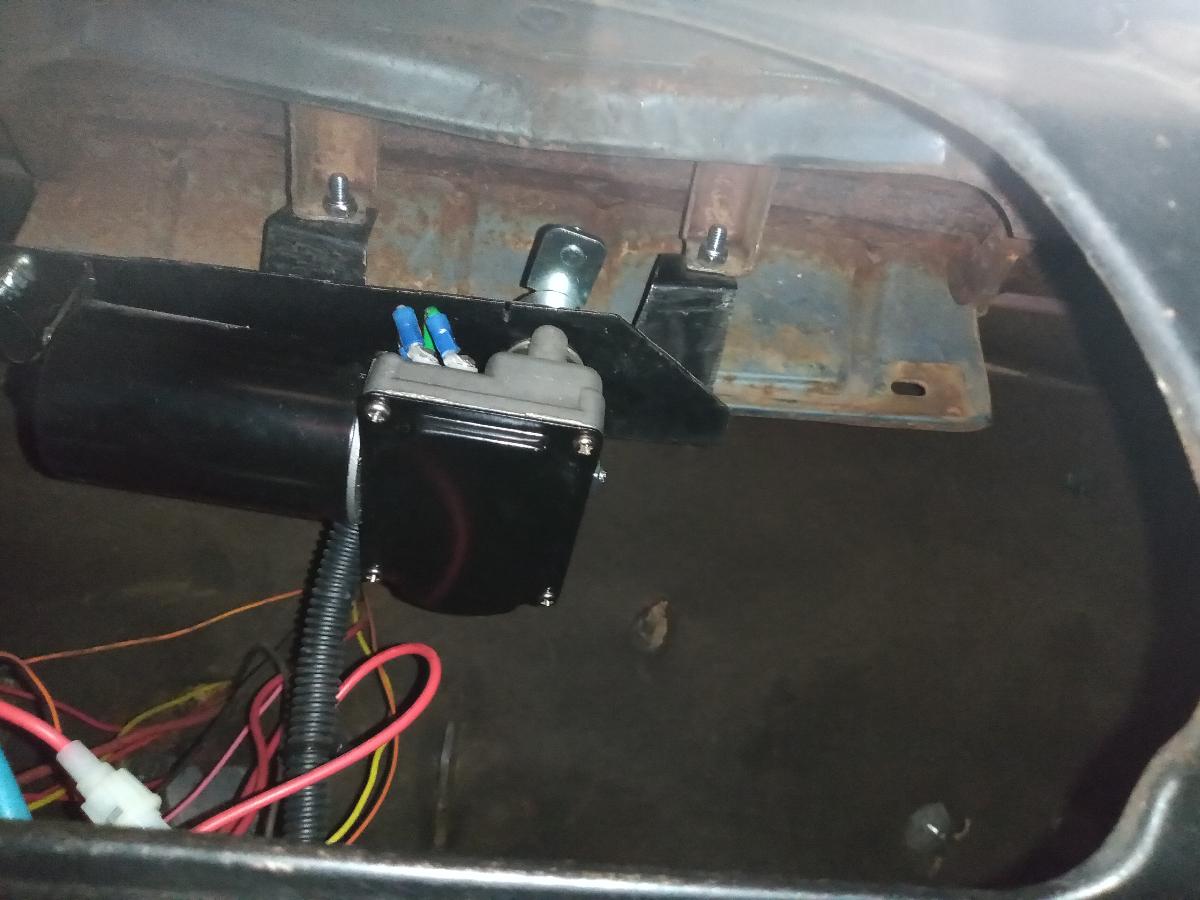

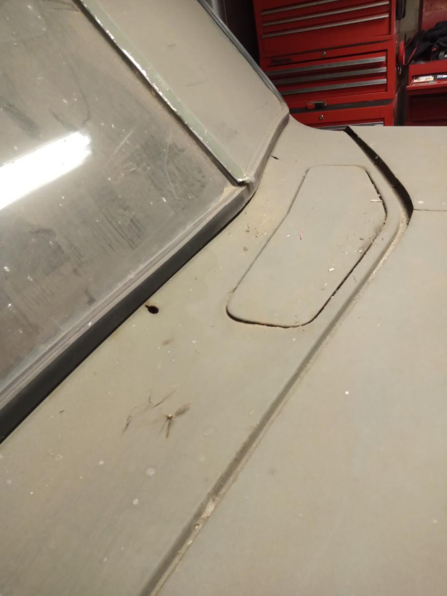

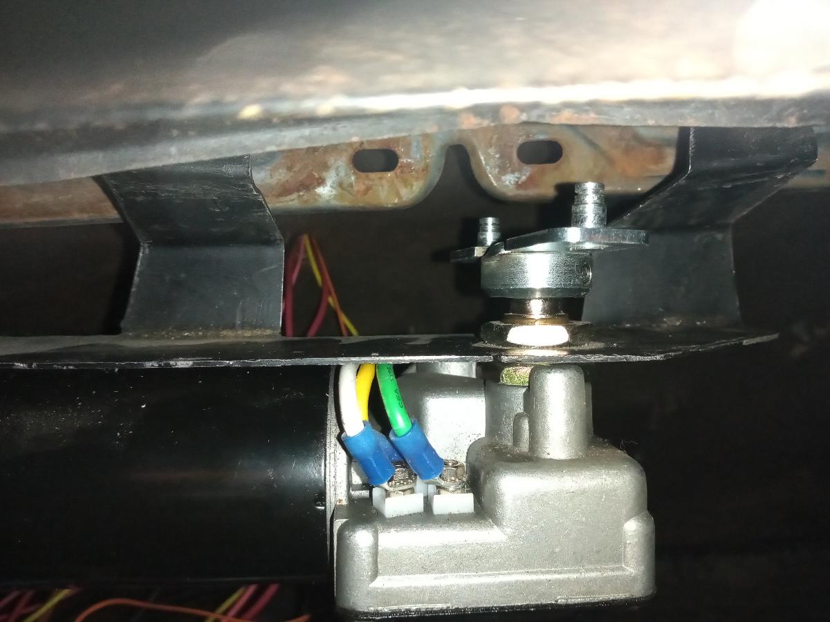

1. I bought the electric motor from Drakes.

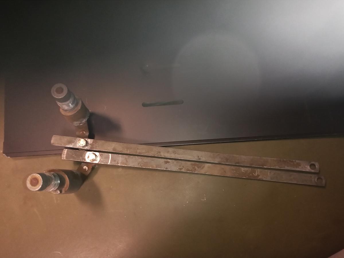

2. I tried to make up the rest of the linkage (Pic 1) from spare steel and Citroen and Renault parts.
3. The motor is fitted (Pic 2 & 3)
4. Problem was the wipers did not travel far at all and looking at photos on page 3 of Drakes catalogue the ends were not correct.
5. I have asked Drakes of they do these parts but they only do the motors and the blades
6. The system that lots of people advertise is for the 46 to 48 and again if you look at page 3 of the drakes catalogue you can see the difference min does not have the rubber grommet type fittings.

From the photos and description of your problem, it looks like the arms are too short. Install one arm and move it so that the wiper is about 1 inch from the center divider, turn the motor so that the operating arm is at the end of its travel and then measure the length needed. If the arm is too short, you will have to make another and there is no guarantee that it will work correctly. I would go with the NOS parts and get "Maud" on the road again.
