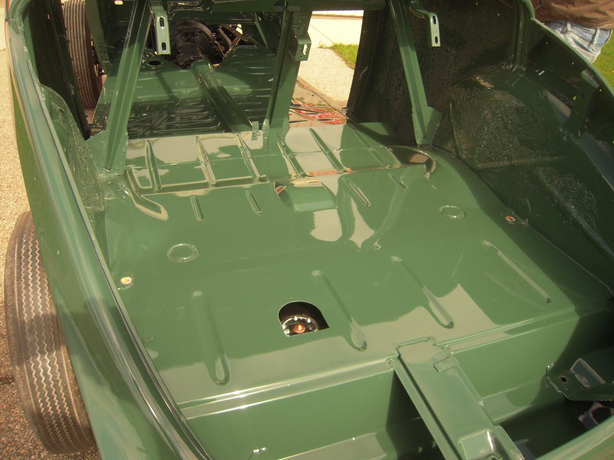

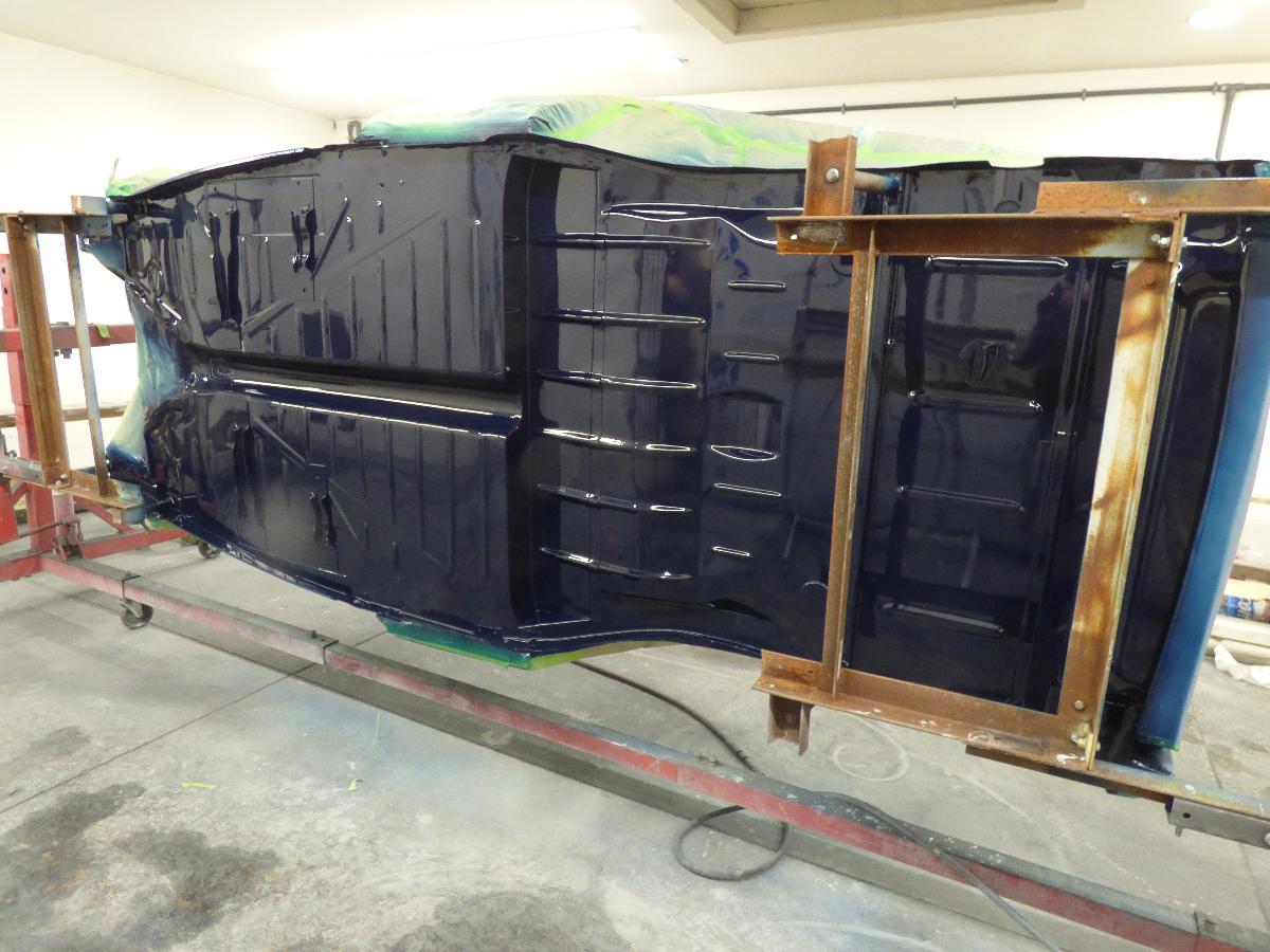

Gil, while there was most likely not a coat of paint that resembled the outer body applied to the underpan, there was still enough to cover the sheet metal. Did that happen 100% of the time? Considering the assembly line was meant to move very fast and factoring in human behavior, well, there were probably a number of cars that got "cheated". The INTENT / DESIGN was to cover the underside of the body as well as the floor with color. Thus, the underside on your car should be Cloudmist. On the concourse, anything other than matching color should result in a point deduction. The car in my photograph is surely well beyond what Ford did but should give you an idea of the "intent" Ford had.

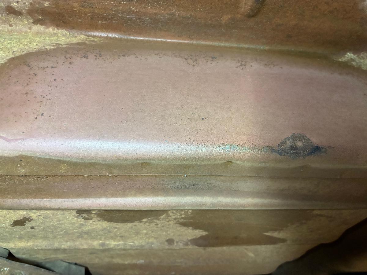

My car apparently got cheated. I find it interesting that they called the color Cloudmist Gray instead of Cloudmist "Green" but I guess that was a marketing decision. Attached are a couple of pictures of the bottom of my car (primer) and a shot of the body inside the left rear fender (Cloudmist Gray). I plan on using acrylic enamel with a hardener to paint the body color. Enamel with a hardener is a great product that is far superior to the original paint. I will probably use POR 15 to do the gloss black frame and suspension unless anyone has a better suggestion.

Keep in mind, after 85 years, any paint that had been on the bottom would often enough be long gone. I agree with you... Gray it isn't. However, Ford got to decide what they called it

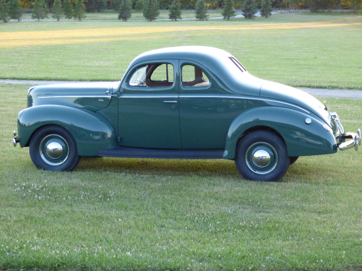

I had heard that another car company used the same color and called it Cloudmist Green, so of course, Henry couldn't use the same name. How true that is, I can't say for sure... Love the 40 Coupe in this color. I had a 1940 Standard Opera Coupe in the same color. Loved this color.
