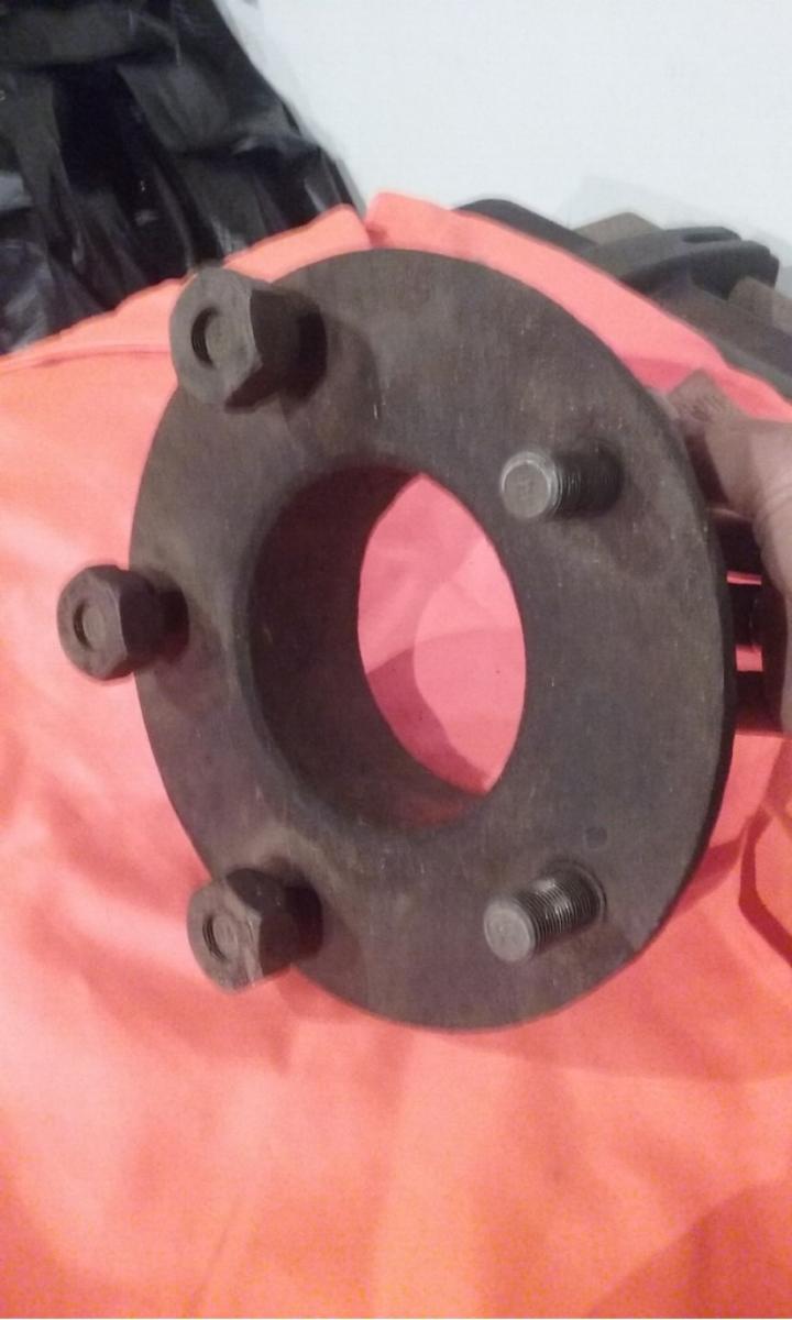

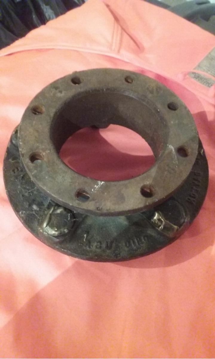

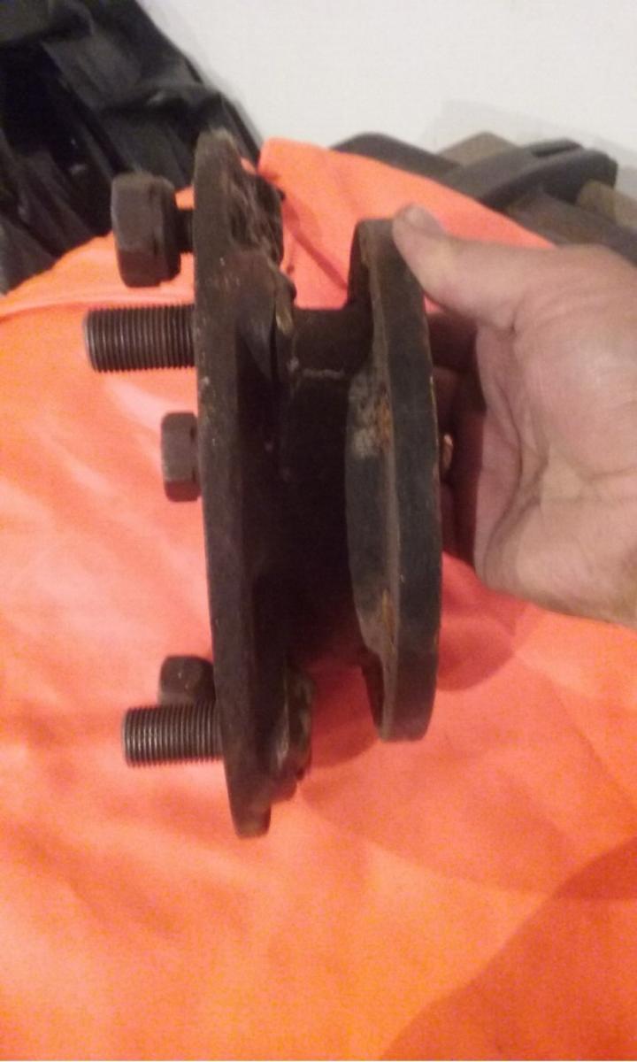

Also there were after market kits sold to convert truck to DRW. I got real lucky years ago and found one of these kits. I’ll add pics of the kit’s spacers Stu

I’m not a fan of the spacers that mount a second outer on top of the inner stock wheel. Strains bearings. But here’s what I’d suggest keeping in mind. Your stock 16” wheels are 6” wide. A stock 7.50-16” tire has a section width of about 8 3/4”, and my Tire and Rim Association reference says you need about 1.5” between the rear duals to avoid rubbing sidewalls. Mounting the duals with their backs to the stock inners makes for a really long spacer. If you’re planning to flip the duals backwards that’d save a few inches but isn’t how the wheels are designed to mount. Not sure they’d even mount that way.
An all round better way to go about this would be to find a common Dana with 8 x 6.5” pattern from a later dually and swap in the whole axle. Stu
