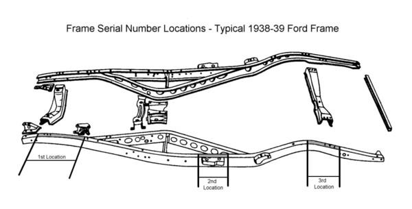

Thanks Administrator! Just trying to picture that location you suggested
51504bat
07-14-2026 @ 11:53 AM
Posts: 384
Joined: Apr 2020
On a 1933 Ford, the serial number (or VIN) was stamped directly onto the top surface of the left-hand (driver's side) frame rail at the factory.The number is typically located in three places on the rail:Front location: Between the firewall and the radiator (the only spot usually visible without removing the body).Center location: Under the front floorboards.
