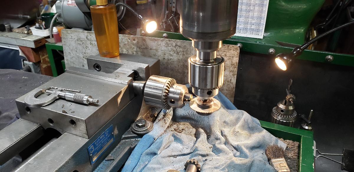

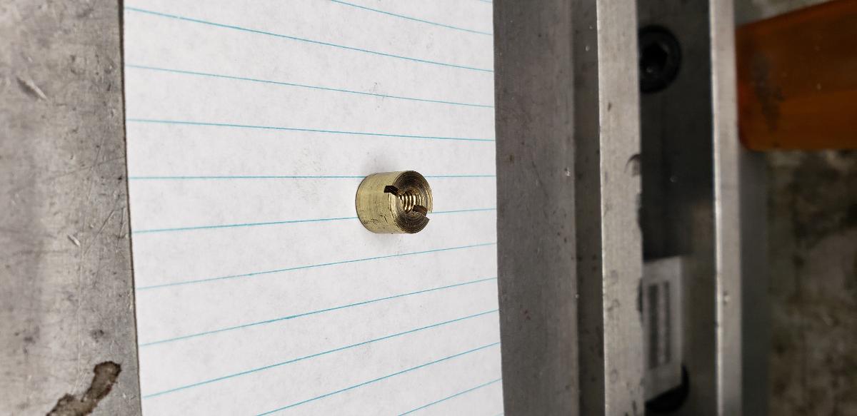

Thank you, I,m working on a fastener order for them but I,ll machine an emergency spare. If I use the diameter between the peaks of a conventional hex nut will I be close to the round diameter?
3w2 |
04-15-2024 @ 3:13 PM
Posts: 819
Close enough for an emergency spare.
nwjm |
04-15-2024 @ 6:45 PM
Posts: 28
Joined: Dec 2023
Thanks again. Will this special nut that I made tonight be close enough for a spare?
