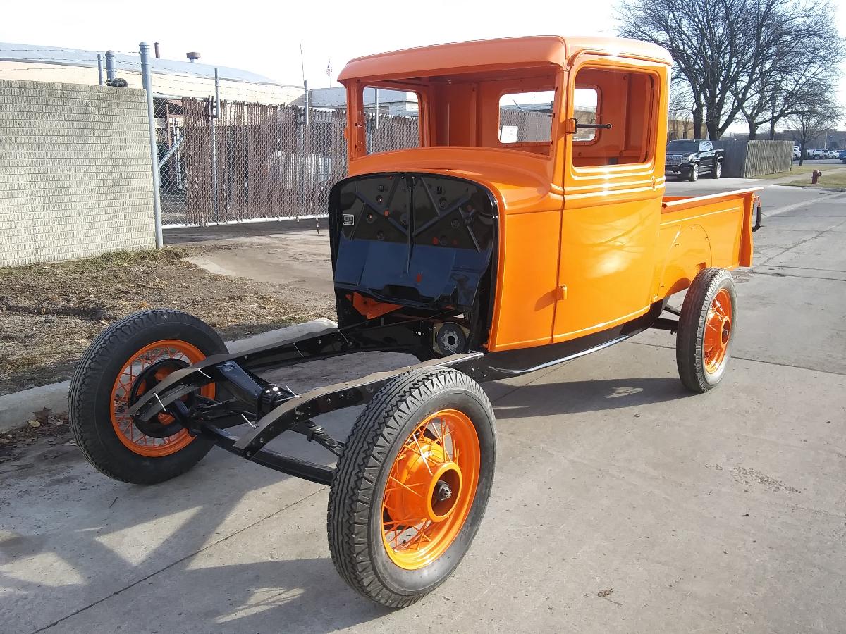

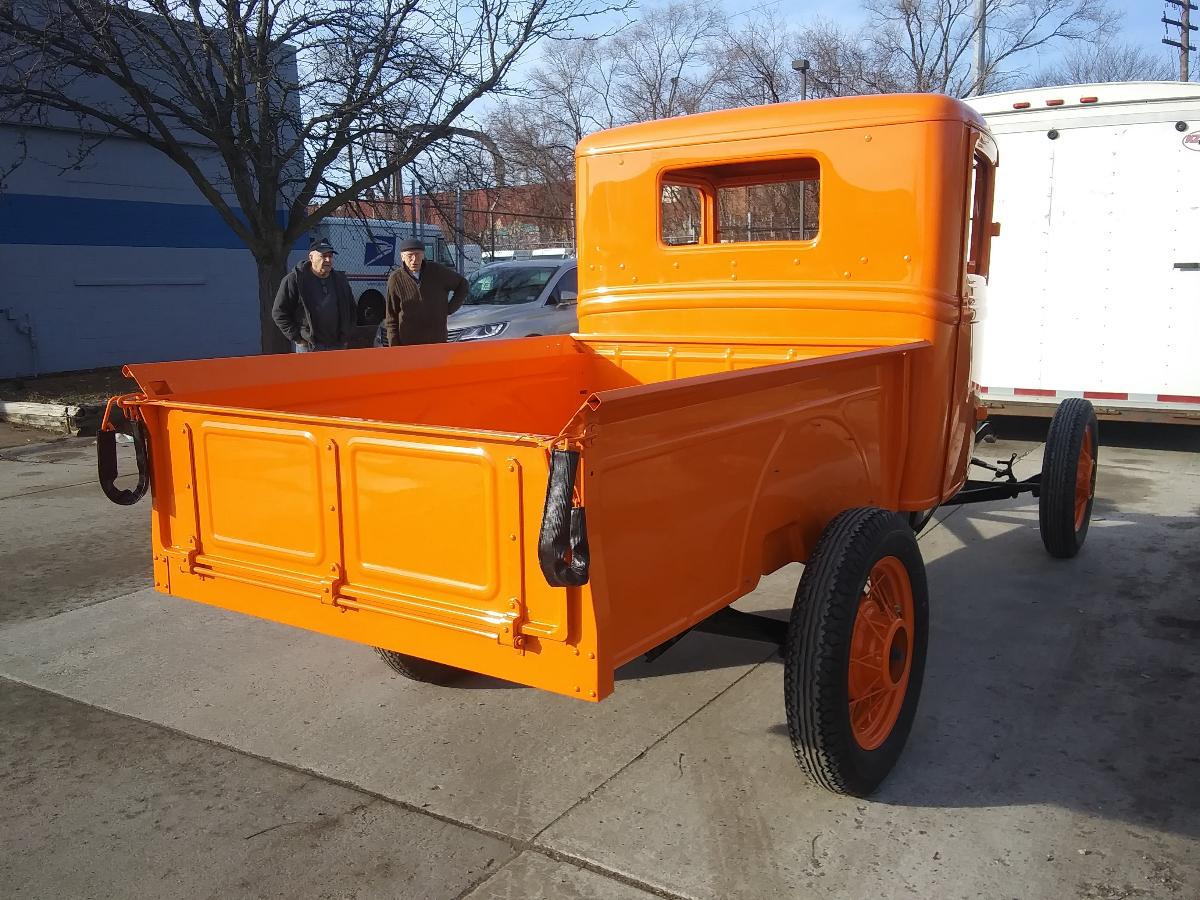

Its a project for sure. The truck has been in the family for quite some time, but needs quite a bit of restoration. I'm not really sure where to start on it. Was wondering if I could get some pointers from some people who have done it here.
Here is the link to the photos.

Excellent collection of photos. You should add your general location to your profile so suggestions will be for resources that are near to you. Is the master cylinder mounted yet?

The book won't show you where the master cylinder is located. Ford didn't go to hydraulic brakes until 1939 but from the drums it looks like someone was doing a conversion. The truck should have rods for the brakes but as I said it looks like someone started to convert it. Follow the lines coming out of the backing plates and it should lead to the master cylinder if there is one. Get some pictures.
