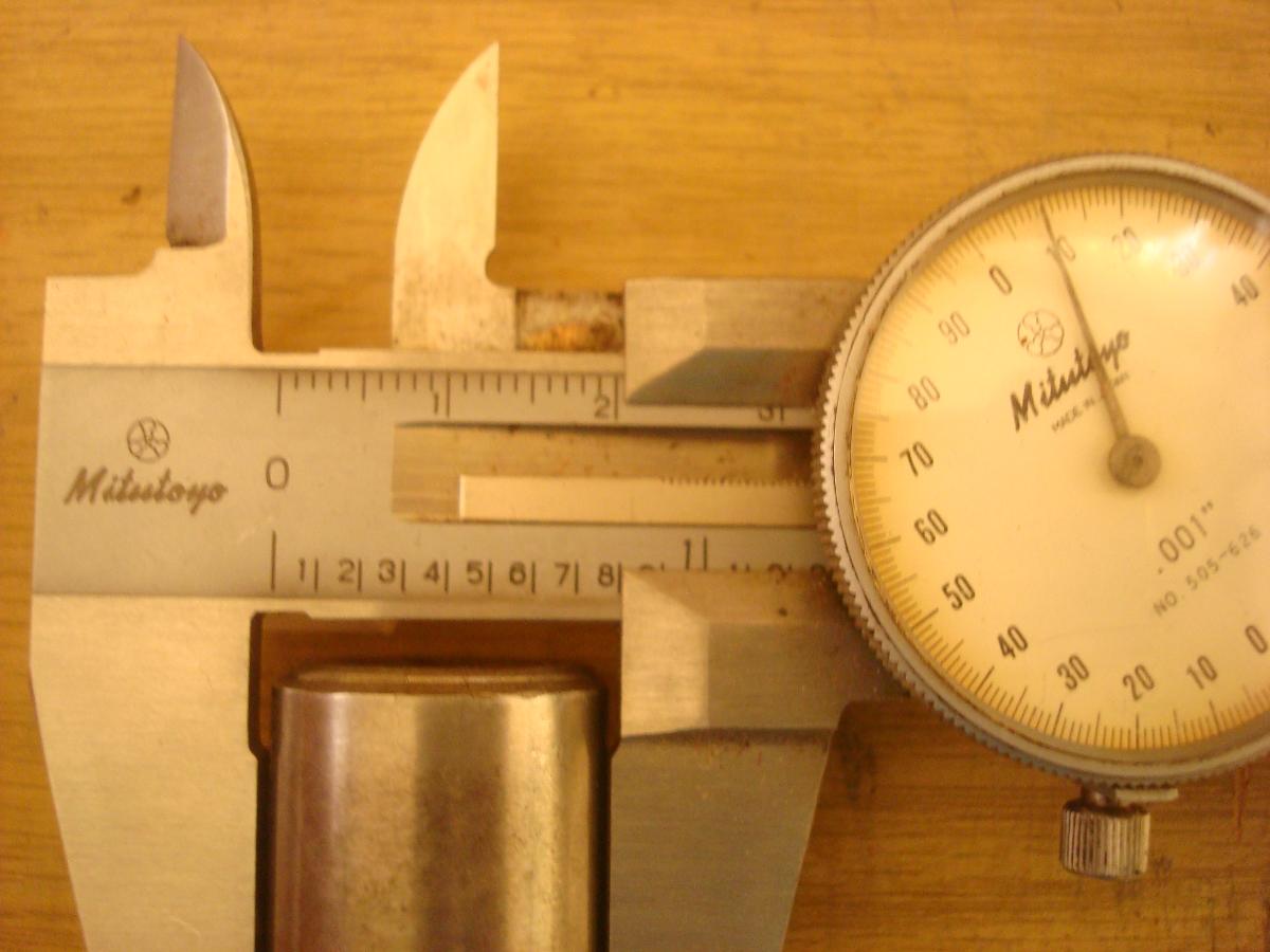

Posts: 1940
3w2 That's what I thought, but was not certain and did not want to steer someone in the wrong direction 28 to 48 FORD PASS king pin bushing's are the same for the most part, photo's sure would help trying to figure what is the problem., what I read was the king pin that did not fit into the I beam axle , is this correct ? maybe the axle was modified,? a original FORD king pin is around3/4 inch I posted a photo of a NOS FORD KING PIN, my cents 37Ragtopman
