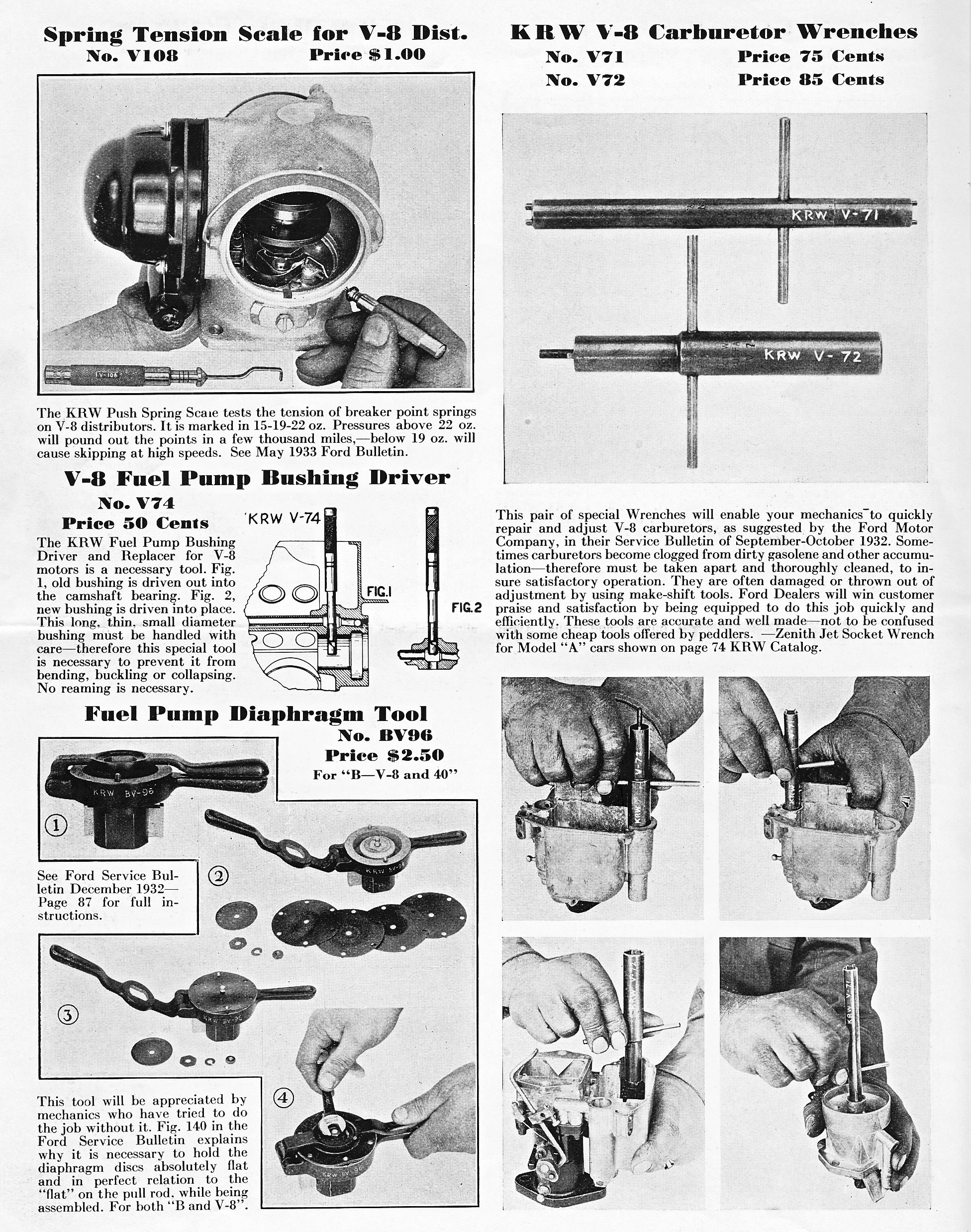

I put the Stromberg back on. Spoke to some guys who run DL all the time and they mentioned I may not have good vacuum with the manifold and at the base of the accelerator pump there is a valve that I did not clean out. I need a tool that has two pins on it to release the cover of the valve at the bottom of the accelerator pump shaft, does anyone know if anyone reproduces this? or even know what that tool is called? Had a great time at the Meet, thank you to all who organized it and helped make it a success! BRL

Brad, It is a K.R. Wilson tool (V-71) as shown in the photo below from Appendix 21 of the Club's 1932 Ford book. Its use is detailed in the September-October issue of the 1932 Service Bulletins, which are readily available inexpensively in reprint form. Dave
