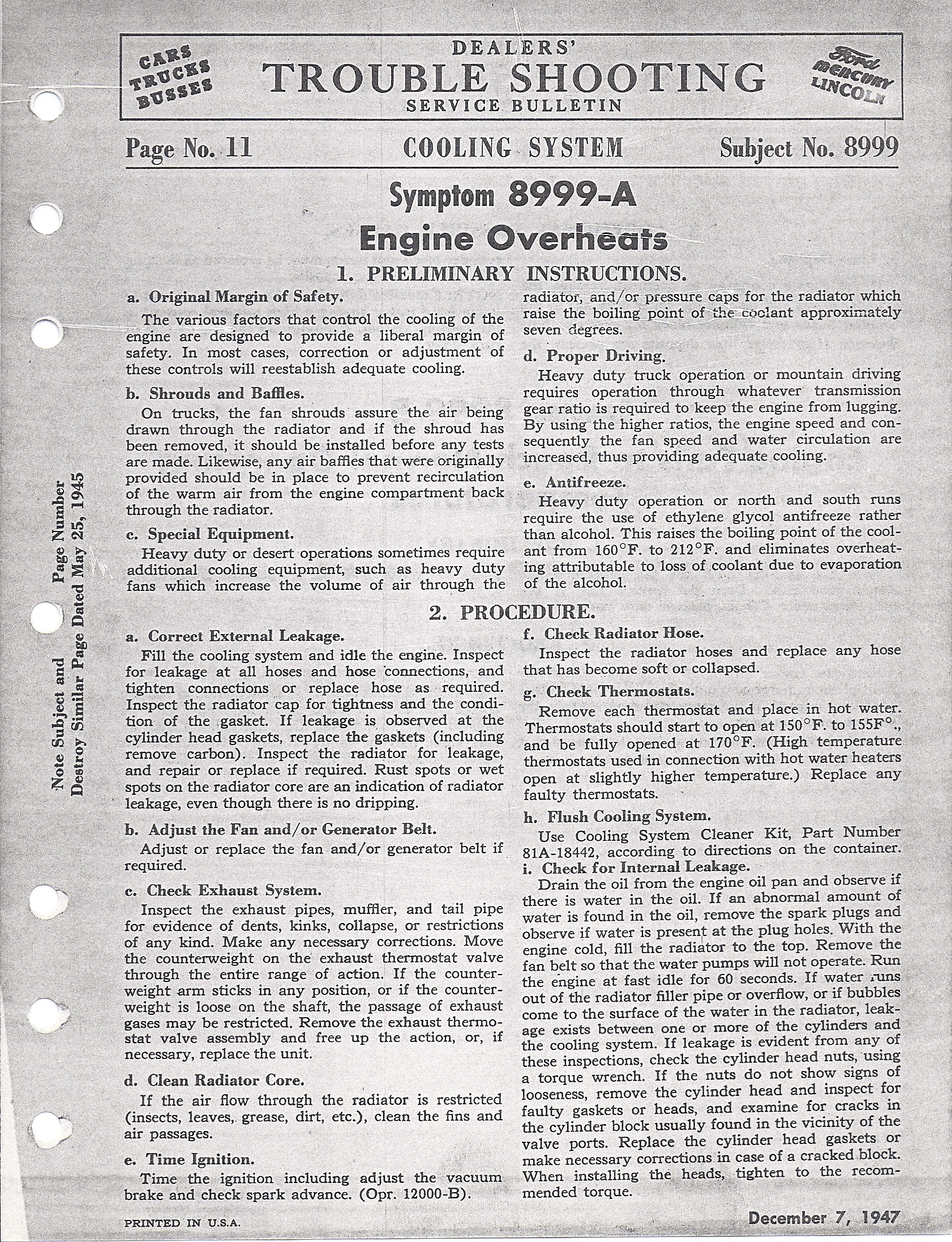

Ford did not use a pressurized radiator cap in 1940 or 32 thru pre war. I used to run a 3# cap and found with use the top of the 40 radiator would bulge outward and would not return to the proper shape after cooling. The top tank is very large and easy to distort, especially over time and with some minimal pressure. The Ford procedure for correcting over heating has some basic steps before removing the radiator, the procedure is below. The procedure below could have a couple of additional steps added at the end. Have the water pumps rebuilt so they have better water flow. Make sure there is not a leaking head gasket (do a compression check and check spark plugs also look for exhaust gas bubbles in the coolant). Remove the engine heads and replace the head gaskets, make sure they are on properly with the small coolant holes toward the front of the engine block and larger holes in the rear. The last step would be to remove the oil pan and the welsh plugs in the engine block oil pan rail. dig out foundry sand at the rear plugs and flush out especially the rear of the block with clean water. There is usually a lot of sand left from the manufacturing process. The sand does NOT usually cause overheating but can cause some hot spots in the engine block. Good Luck

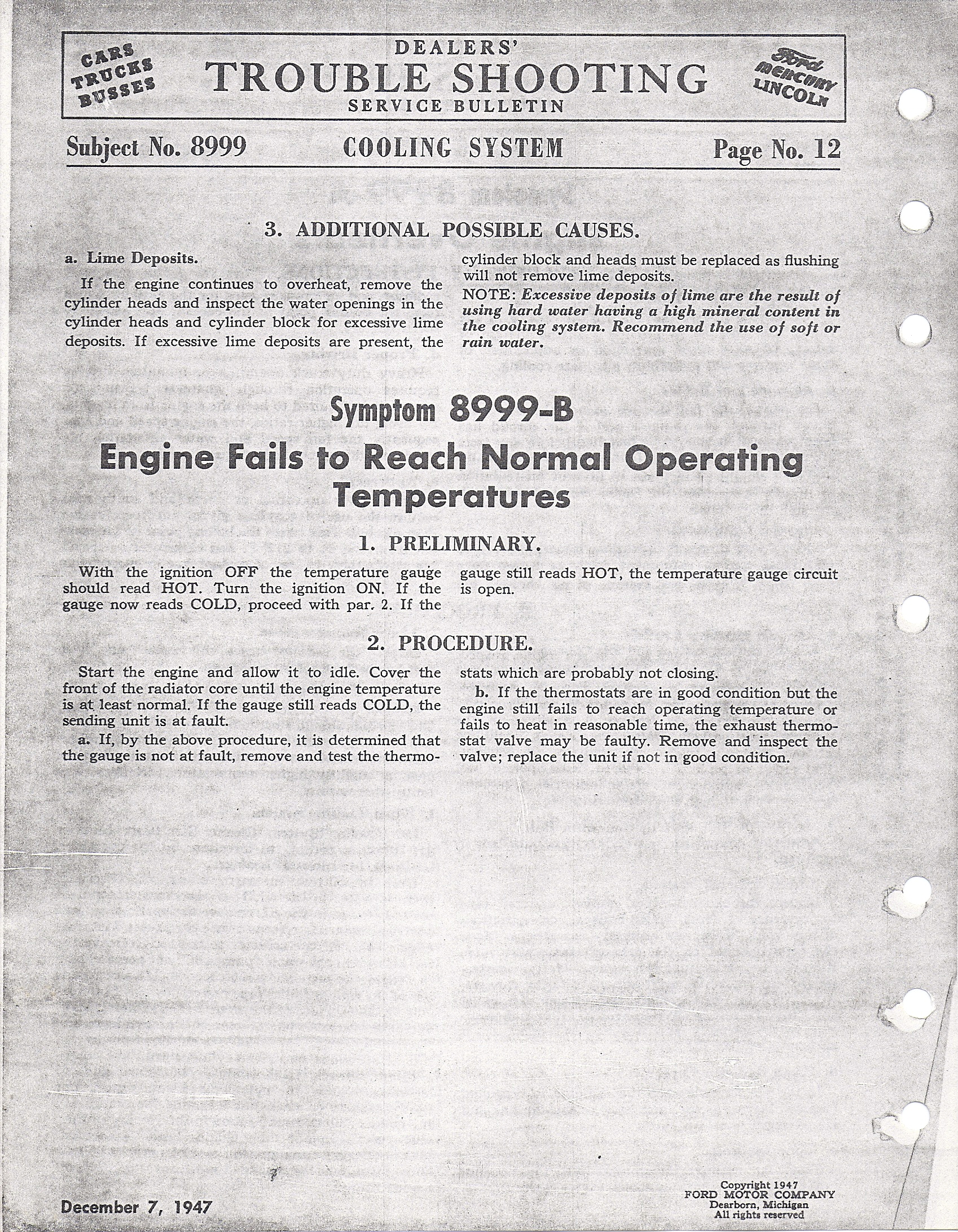

Second and final page of coolant Doc.

Steve has offered wonderful advice.
155° was in fact the stock thermostats from the factory. I use them in my restorations and have found they maintain each & every car at a good - operable temperature. Keep in mind though, my restorations include proper rebuilding of all components. The engines are boiled out, the radiators re-cored, distributors and carburetors properly rebuilt.
If everything is rebuilt properly there is no need for high volume pumps and certainly no need for over flow tanks, check valves, etc. While those things may aid "what ails ya" they are no more than bandages applied in an attempt to mask the true underlying issue(s).

Lets talk temp gauge. With ignition on, I have power to the gauge from the Ign switch and 6 Volt across the gauge. In addition, 6 volt out to the sending unit. Maybe someone can explain the circuit to me, as I'm a little unsure how it works. In any case, temp needle never comes off H. reading the bulletin, it implies the gauge needle rests with ign off on H. Once Ign is turned on ( engine cold) the needle should go cold and gradually rise as engine warms. Is this correct description, and if so is the gauge "bad"?
