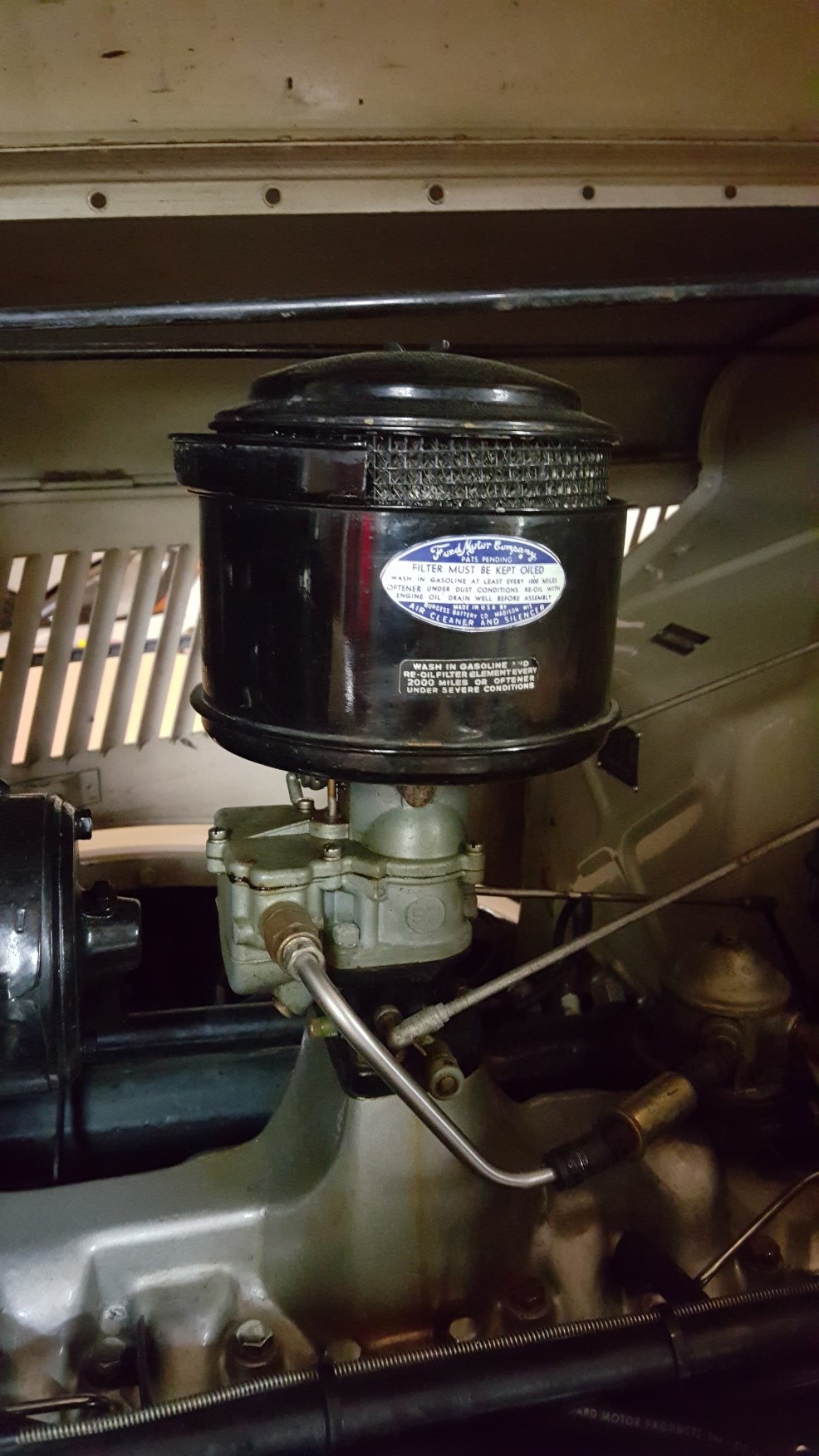

I'm curious to know what yours looks like. Here is a picture of the one on my phaeton. With the wing nut and top removed, the mesh comes out easily.

jwitt - I believe your pictured air cleaner is for a later model V8. Probably '37-'38 or later. More convenient for sure and someone will probably chime in.
