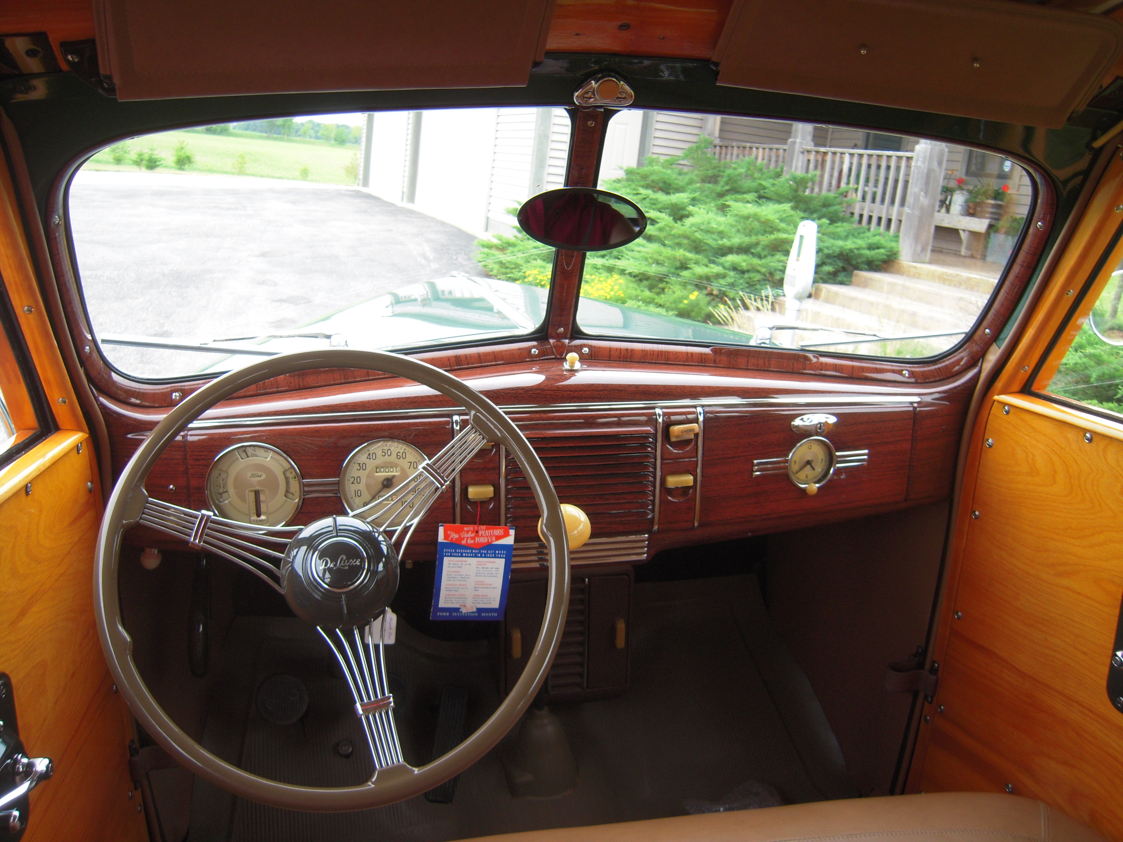

Here is what the dash should look like:
07-13-2011 @ 5:30 PM
Posts: 2883
Rod, Planjonc has posted the answer to your question, and the picture posted by Supereal being that of a 39 DeLuxe Station Wagon, is very similar to your Standard, with some differences unrelated to your dash question. Mac Van Pelt has owned up to maintaining the website you found, one of the most useful, containing a lot of flathead info.

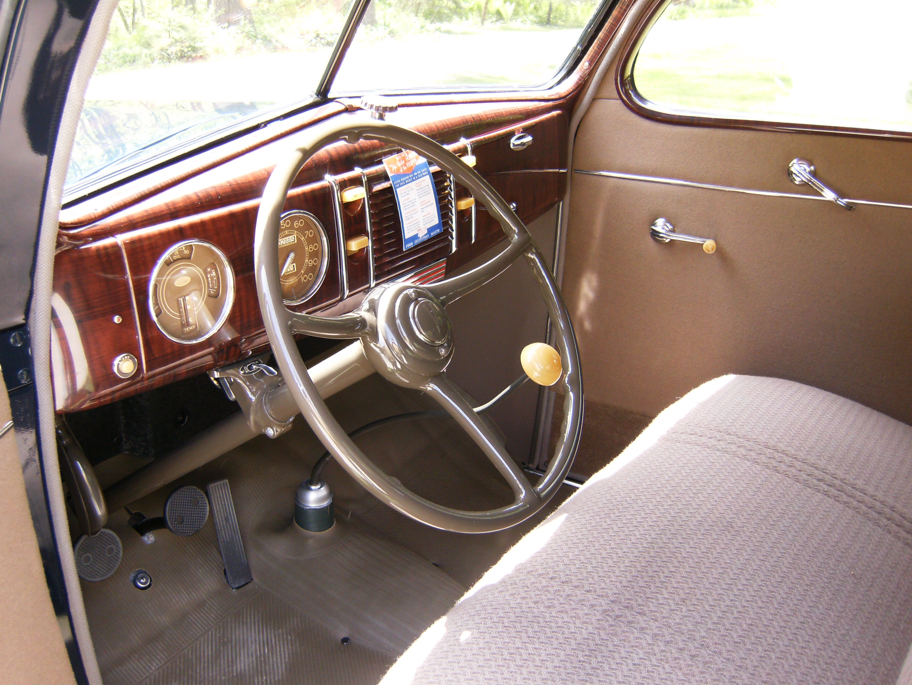

Here's a photo of a 39 "standard" model.
Note the red stripes in the radio delete plate should be brown, not red.
