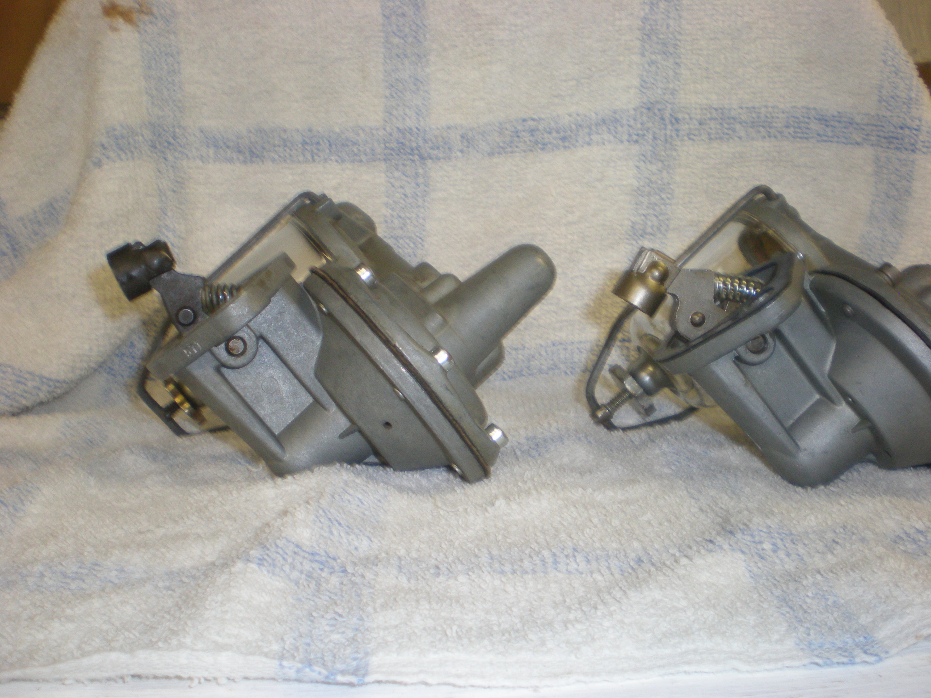

Fordmerc, you earlier said that you assumed that the pump was original to your car. It was in fact first supplied on '48 Fords and Mercs, therefore not correct for your '39 Merc. If you are not concerned about originality, this pump should serve you well if the kit is installed as TomO instructed.
fordmerc
07-03-2011 @ 6:14 PM
Posts: 180
TomO: I did it wrong and opposite of what you describe; I'll try again
37Ragtopman: You can bend the fuel pump pushrod when you leave an unsecured engine in a trailer and go around a corner fast thus causing the engine to roll over. (During this maneuver, the fuel pump and tower had been removed to assure maximum damage to the protruding rod!) However, this was before the engine was rebuilt and the rod was replaced before the engine was installed. If the replacement rod is not made correctly, then it could be the problem, however, by measurement, it is correct. The rod moves up and down smoothly and vertically now.
Car is 95 HP '39 Mercury (aluminum intake manifold).
I attached (?) an image of my fuel pump on the right and one that works (from a '39 Ford) on the left. The one on the left works on my car, but it is not mine and must be returned to the owner. The difference is the angle of the pump arm lever, but everything taken alone looks fine - not bent, folded, stapled, or mutilated!
